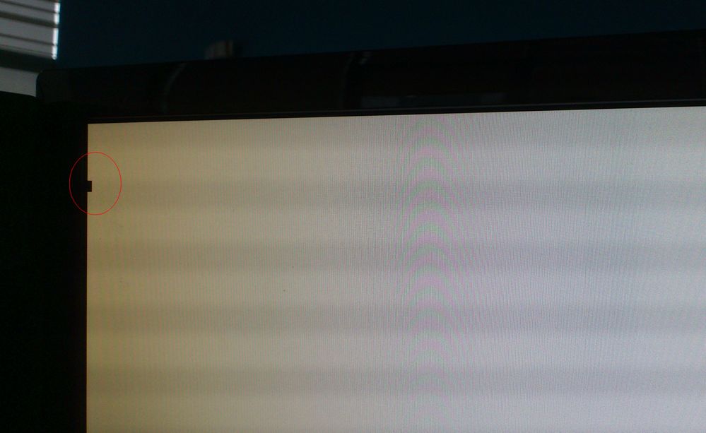

Hello
     My board is IMX6Q-SDB. When I test the node of /dev/fb0,the video output by HDMI.I find a black point on the left of the screen.You can use the demo of mxc_fb_test.out to see it.
     How can I solve it?
     Thank you.

Which release are you using? Can you change another HDMI display to test?

LTIB:3.0.35_4.0_130816
I find it is the cursor.

As for cursor, You may try the following to stop blinking cursor:
# echo 0 > /sys/class/graphics/fbcon/cursor_blink
or in order to  hide cursor:
# echo -e '\033[?17;0;0c' > /dev/tty1 (from serial console)
or
# echo -e '\033[?17;0;0c'    (from framebuffer console)

Now ,I  through modify the kernel file of fbcon.c to stop blinking cursor .

OK. Thanks for update. This version should have no problem, I verified it on my side.
