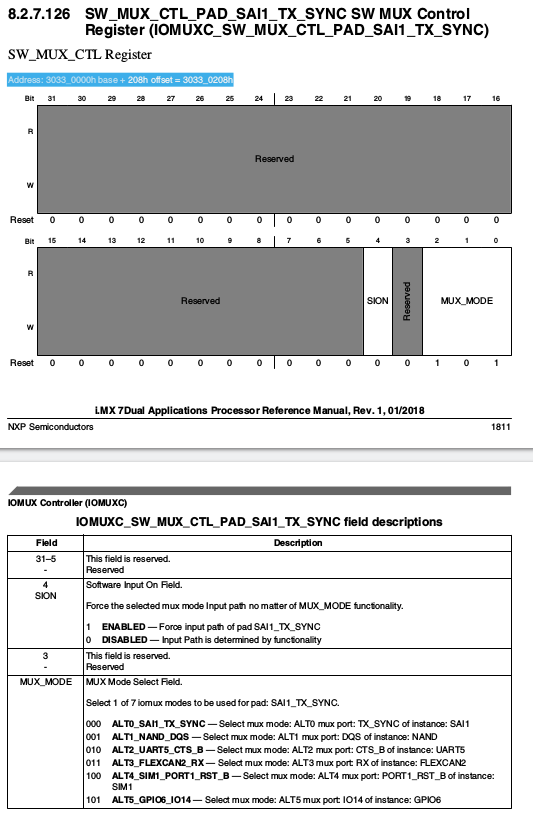

Hello im triying to define custom pin settings for in devicetree but im not understanding register value
for example
MX7D_PAD_SAI1_TX_DATA__GPIO6_IO15 0x1b << this registers
MX7D_PAD_SAI1_TX_BCLK__GPIO6_IO13 0x80000000 << this registers
i inspected to referance manual tables, pin multiplexing topics but i could see any answer my question
Other example i will select under picture this pin ALT5_GPIO6_IO15
What is this register's name and how i can calculate this register lastly what is Reserved meaning

for 0x80000000 one can look at linux documentation
linux/Documentation/devicetree/bindings/pinctrl/fsl,imx-pinctrl.txt
fsl,imx-pinctrl.txt\pinctrl\bindings\devicetree\Documentation - linux-imx - i.MX Linux kernel
"MX7D_PAD_SAI1_TX_DATA__GPIO6_IO15 0x1b << this registers"
makes setting for register IOMUXC_SW_PAD_CTL_PAD_SAI1_TX_DATA
described in sect.8.2.7.283 SW_PAD_CTL_PAD_SAI1_TX_DATA SW PAD Control
Register (IOMUXC_SW_PAD_CTL_PAD_SAI1_TX_DATA) i.MX7D Reference Manual.
Description of device tree can be found in AN5125 Introduction to Device Tree
