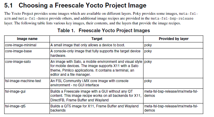

I can build core-image-minimal image without any problem. But when I tried to build core-image-full-cmdline, I got an error and stopped. has anyone experienced this kind of issue?
bruce@bruce-XPS-8700:~/mc3000-working/fsl-release-bsp/build-q$ bitbake core-image-full-cmdline

ERROR: Function failed: nettools_do_patch (log file is located at /home/bruce/mc3000-working/fsl-release-bsp/build-q/tmp/work/cortexa9hf-vfp-neon-poky-linux-gnueabi/net-tools/1.60-25-r0/temp/log.do_patch.22294)
ERROR: Logfile of failure stored in: /home/bruce/mc3000-working/fsl-release-bsp/build-q/tmp/work/cortexa9hf-vfp-neon-poky-linux-gnueabi/net-tools/1.60-25-r0/temp/log.do_patch.22294

| WARNING: exit code 1 from a shell command.
| DEBUG: Python function do_patch finished
ERROR: Task 1634 (/home/bruce/mc3000-working/fsl-release-bsp/sources/poky/meta/recipes-extended/net-tools/net-tools_1.60-25.bb, do_patch) failed with exit code '1'

brucesun
Hi Biyong,
Do you mean ONLY the images listed in your table are valid for freescale YOCTO release?
Bruce
2,740 Views
BiyongSUN
yes.
The list is we have done the QA.
