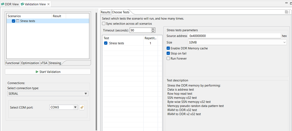

Hi @danielkrol

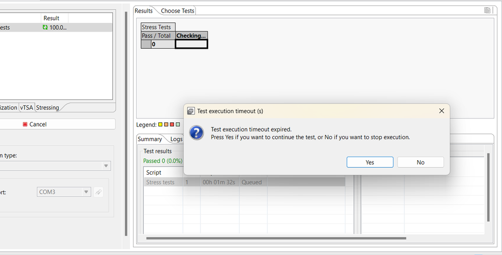

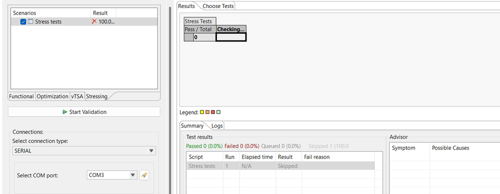

i am facing issue  on sress test using config tool . you have any idea please suggest where I I did the mistake
I select  the "NO" option  . if I select the yes option it is continuously running. it is not stopping execution.

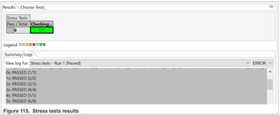

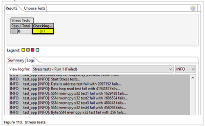

To test the stability of the DDR configuration more extensively, you can use the Stressing scenario, with its suite
of tests that covers different situations.

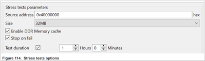

Two ways of running Stress tests are available:
1. Single run runs the test suite one time with different options selected (Size, Enable DDR Memory cache,
Stop on fail). In case of failure, you can check the status of each test in the suite in the Logs console, with
Log level set to INFO
2. Test duration runs the test suite for a selected time. This is suitable for overnight tests.
In the Logs console, you can monitor test execution and see the number of iterations and the duration.
Note: Make sure the Timeout (seconds) setting is higher than the Test duration setting, otherwise the test ends with timeout.
You can find that information in User Guide for Config Tools for i.MX.
