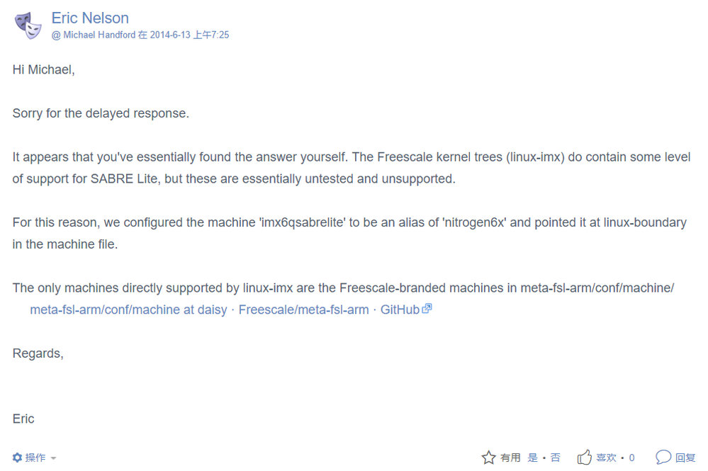

I found an answer at  imx6qsabrelite yocto switching kernel,he said  like this :
It sounds like that  linux-imx_3.10.53.bb can't be installed at imx6qsabrelite, so what should I supposed to do ? What if I compiled with "MACHINE=nitrogen6x"? Will it work for imx6qsabrelite?Or could you provide me a guide for building yocto(L3.10.53) for imx6qsabrelite? Thanks a lot!

Yes you need to use the 'nitrogen6x' machine, it will work on the SabreLite:
meta-freescale-3rdparty/nitrogen6x.conf at master · Freescale/meta-freescale-3rdparty · GitHub
Gary

I changed the" MACHINE=imx6qsabrelite " to "MACHINE=nitrogen6x",but it still didn't work, when I  built scenarios , I used the command like this:
$ repo init -u git://git.freescale.com/imx/fsl-arm-yocto-bsp.git -b imx-3.10.53-1.1.0_ga
it seems like that the 3.10.53 release is not supported, use the yocto branch like "dylan" or "dizzy" may work ,but it is not the release I need , I need the linux kernel 3.10.53 ,so what should I do ? Please help.

The "nitrogen6x" platform is only available in the community Yocto BSP:
GitHub - Freescale/fsl-community-bsp-platform: BSP platform manifest
However there's no community BSP were the Linux kernel is 3.10.53 for Nitrogen6x, why using such an old kernel?
If you want (or need) to use the NXP BSP, maybe the "imx6qsabrelite" is the right machine but we can't help you with it since they dropped SabreLite support early.

the command you use is for list in the machine directory, obviously, imx6qsabrelite doesn't belong to it, as you known,the machine 'imx6qsabrelite' to be an alias of 'nitrogen6x' and pointed it at linux-boundary in the machine file. maybe you can refer to the link as below
