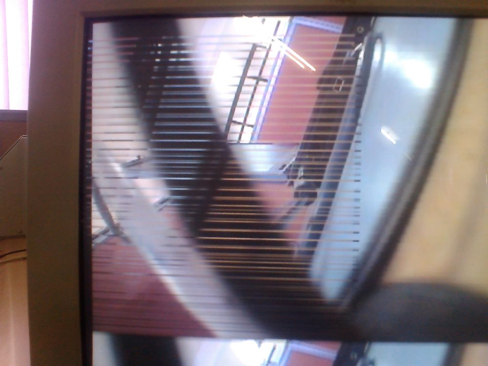

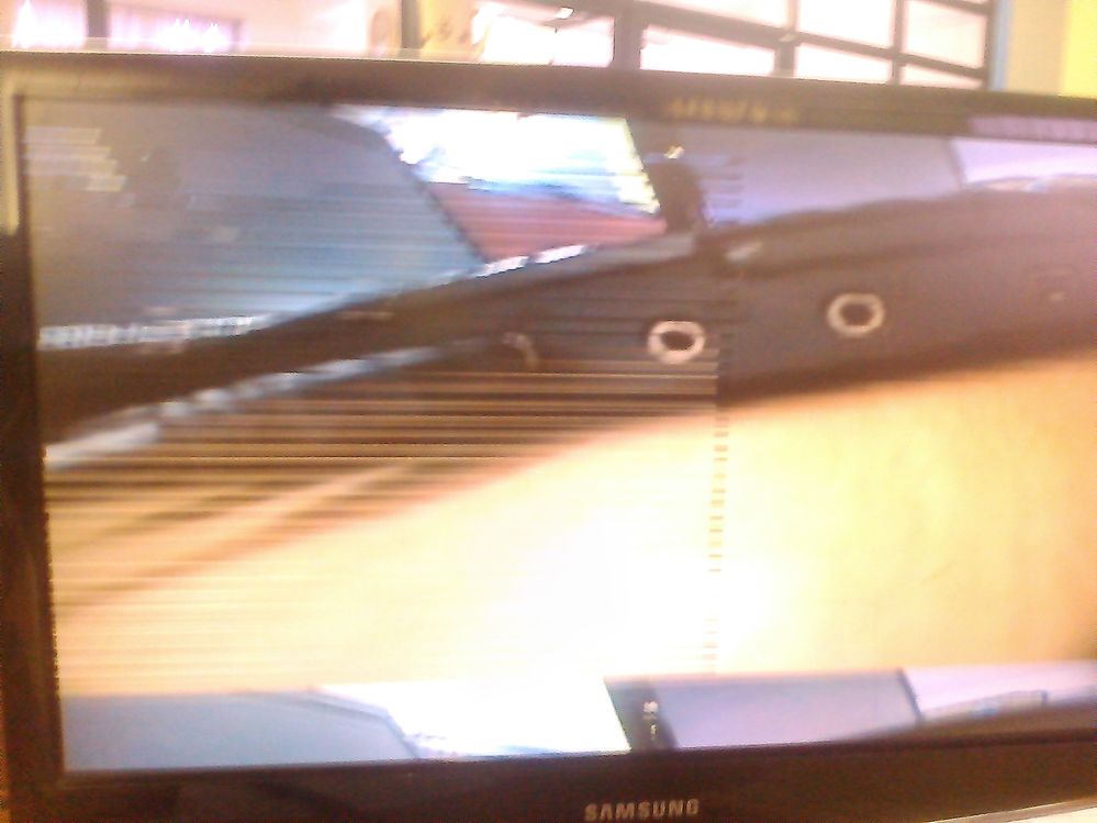

Hello all,
My camera output is in the format NV12 where as the clock overlay will take only the formatts I420 and UYVY, i used the following command and got the clock overlay
gst-launch-0.10 -v mfw_v4lsrc device=/dev/video0 capture-width=720 capture-height=576 sensor-width=720 sensor-height=288 typefind=1 preview=1 preview-width=1024 preview-height=768 ! queue max-size-buffers=10 ! ffmpegcolorspace ! clockoverlay halign=left valign=bottom xpad=20 ypad=20 time-format="%R %d-%b-%Y" font-desc="Sans 15" shaded-background=false ! mfw_v4lsink &
The current observations are.
1, High CPU usage of 76%.
2, The video display is having lines on it till the clockoverlay is displayed (Image1)
3, Slower update of screen if camera is moved once the clock overlay appears on screen.
Jis

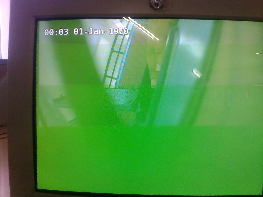

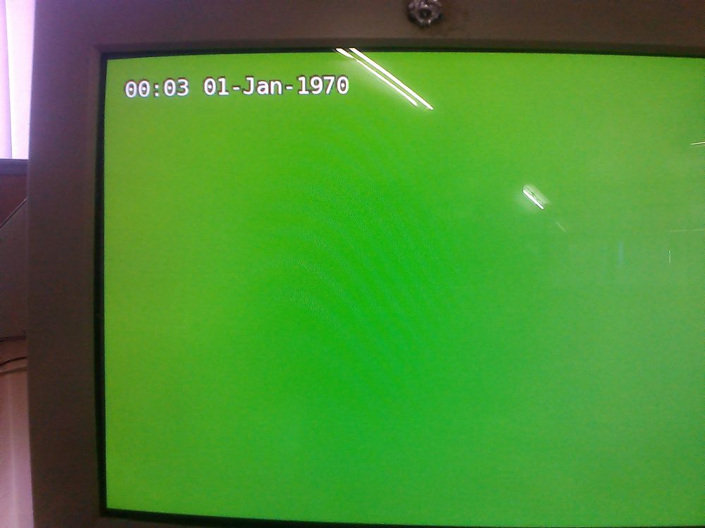

I tried the same using the following command, gst-launch-0.10 -v mfw_v4lsrc device=/dev/video0 capture-width=720 capture-height=576 sensor-width=720 sensor-height=288 typefind=1 preview=1 preview-width=1024 preview-height=768 ! mfw_ipucsc ! clockoverlay time-format="%R %d-%b-%Y" ! mfw_v4lsink &
The clock overlay starts appearing after 30 seconds but the camera is freezed and a green frame was flashing on the screen as shown in the image also in the terminal the following error was displayed "mxc_ipu_hl_lib.c:956 ipu is busy"
Please find attached the image sequences
1,Screen till the clock overlay appears.
2 & 3, Screen with clock overlay.
The CPU usage is the concern here (around 76%) and I wanted to know whether something can be done in imx53 ipu module so that we will get the data from the camera in UYVY format itself and we don't have to do any further color space conversion.Image1.jpg
