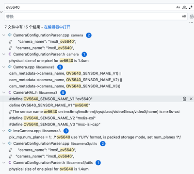

Zhiming_Liu
Hi @ganesh_k
1.You may need modify camera hal driver:
2.You need modify camera config files in device/nxp/imx8m/evk_8mm/
