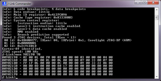

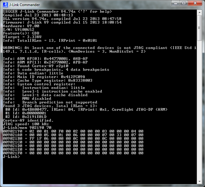

AnsonHuang
Hi, Michael
     When boot fail, were you able to attach the SOC using JTAG, if yes, can you please help dump some data for me? the physical address of 0x902190 ~ 0x9021f0. Thanks.

michaeldiamond
I think this might be what you asked for.
And this is what it was after I booted it from USB puting the u-boot image into RAM.

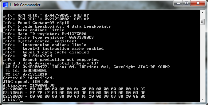

AnsonHuang
Hi, Michael
     From this log, I can see that the boot device is indeed from SD1, the failure reason is ROM_LOG_DEVICE_INIT_FAIL, that means SD1 device init failed. I wonder whether this boot fail is everytime fail or just randomly? ANd, can you help dump the USDHC1's register? We want to know the SD init fail at what command. 0x2190000 ~ 0x2190020.

michaeldiamond
Here is the 2190000
