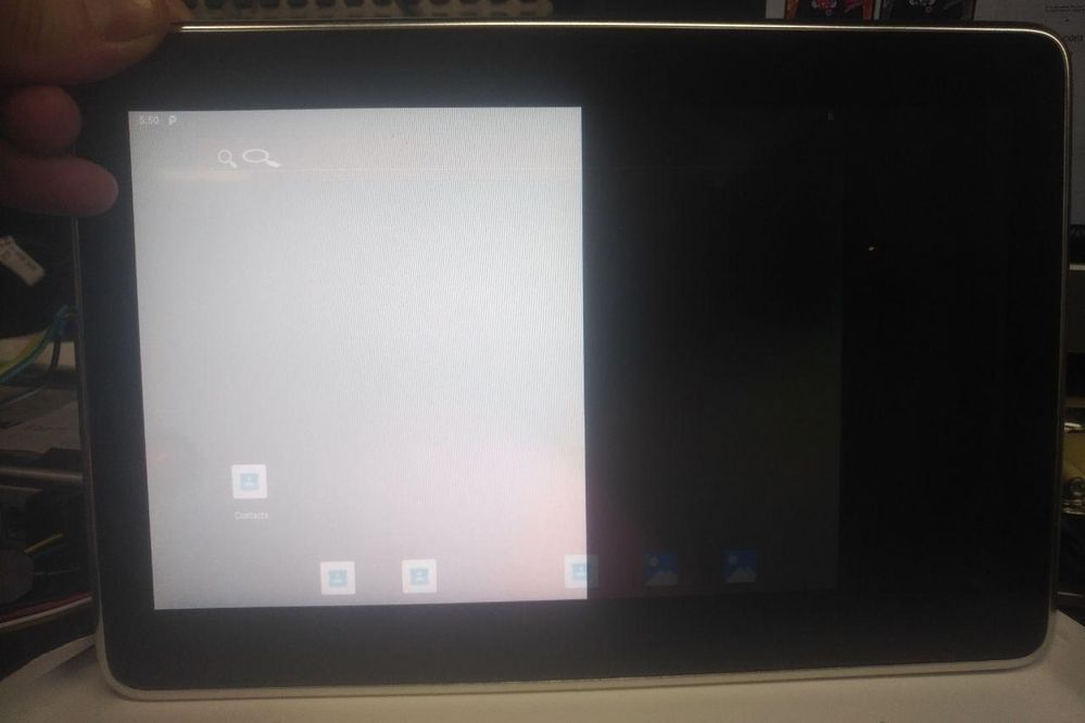

i build android 9 for sabre sd board, in uboot set screen parameters
setenv bootargs console=ttymxc0,115200 init=/init video=mxcfb0:dev=ldb,1280x800M@60,if=RGB666 video=mxcfb1:off video=mxcfb2:off fbmem=28M vmalloc=400M androidboot.console=ttymxc0 androidboot.hardware=freescale
and get strange picture on screen, i get same picture when start prebuild android 8.0 from nxp site

solved by moving "primary" paraneter from  lvds-channel@1 to  lvds-channel@0
