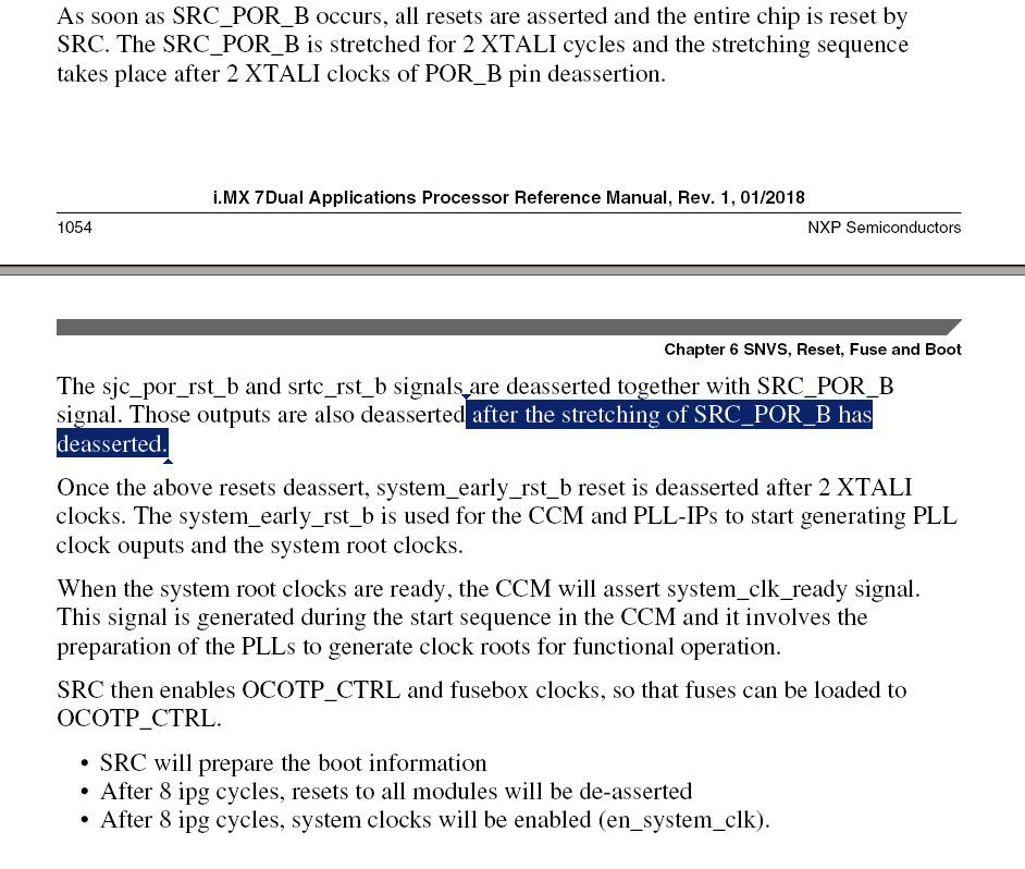

igorpadykov
Hi Goto
>In the case of Internal POR, is the release timing of the reset inside the CPU when
>both VDD_ARM_IN and VDD_SOC_IN are supplied?
in general yes. However please note that "Internal POR" case was not validated
and not recommended in practice, recommended to use option with externally provided
POR.
>In the case of BOOT with QuadSPI (QSPI) flash, what is the delay time from the supply
>of both VDD_ARM_IN and VDD_SOC_IN to the start of access to flash?
Such delay is not specificed, as it depends on many factors. Please refer to below
part of Reference Manual describing reset timings.
igor
