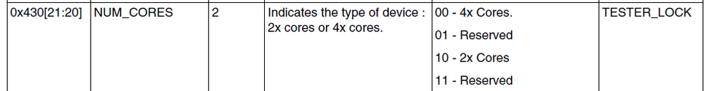

The i.MX6Q and i.MX6D are the same die, they're just fused differently. Here you can check the uboot fuse NUM_CORES, in our reference maunual you can see the 0x430.
i.MX6 Quad versus Dual differentiated by fuse NUM_CORES .

So sorry for above reply, the i.MX6D software is the same with the i.MX6Q. When the power the board, and system running, it will detect the chip. Here your error maybe caused by the DDR configuration, you can use the ddr test tool to test it first.
