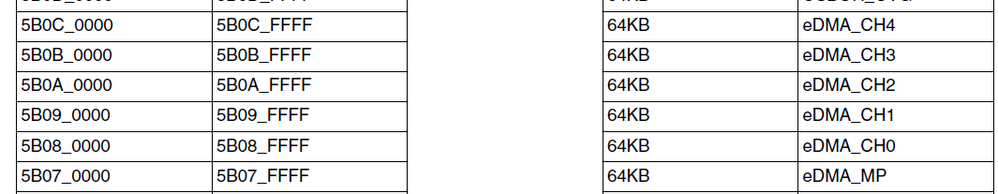

In IMX8DQXPRM(Rev.D 11/2018).pdf I saw register memory map list as below:
This is register map of eDMA  in Connectivity subsystem.
My questions are:
a.I can NOT see which peripherals associated with those 5 Connectivity's eDMA channels.
b.What the difference between Connectivity's eDMA and ADMA's eDMAs?
c.If I want to access ADMA's eDMA controller register(0x5a1f0000), which clock domain and gates need to be enabled? now I can access ADMA's eDMA's channel register, but cannot access ADMA's eDMA controller register.
d.Can all those channels perform moving data from memory to memory?

Hi Li
a. one can look at Figure 16-1. Audio Subsystem High-Level Block Diagram,
Table 16-2. eDMAn Channel Map  i.MX8QXP Reference Manual
https://www.nxp.com/docs/en/reference-manual/IMX8DQXPRM.pdf
b. one can look at architecture description in Figure 1-1. i.MX 8QuadXPlus/i.MX 8DualXPlus
Simplified Block Diagram, Chapter 14 Connectivity Subsystem
c. for eDMA2((0x5a1f0000) one can check clock control LPCG_EDMA2 descriptions
in Table 8-4. System Clocks, and Gating, sect.8.4 Low Power Clock Gating Control
d. yes
igor

Hi Igor,
Thanks for your quick reply.
I also have something else not clear:
a.I can see the details about Audio Subsystem eDMA controllers eDMA0~3, but nothing about Connectivity eDMA controller(may be could called eDMA4). Does eDMA4 (0x5b070000~0x5b0cffff) work? Is there no peripherals be associated with those 5 channels?
c. I still meet: In Connectivity, LPCG_EDMA_REGS (0x5b2a0000)  can NOT access, but LPCG_RAWNAND_0_REGS(0x5b290000) could.

igorpadykov
Hi Li
a. "Connectivity Subsystem" is just another module which has own eDMA module.
please check Figure 14-1. Simplified Block Diagram in Chapter 14
Connectivity Subsystem Reference Manual.
b. one can check eDMA examples in SDK for i.MX 8QuadXPlus (SDK_2.5.0_MEK-MIMX8QX)
available on
Welcome | MCUXpresso SDK Builder
For specific issues with eDMA development may be recommended to proceed with
NXP Professional Services | NXP
Note this part is "Preproduction" as described in red on below link  - so there no full support for it.
i.MX 8X Applications Processors| Arm® Cortex®-A35, Cortex-M4 | NXP
igor
