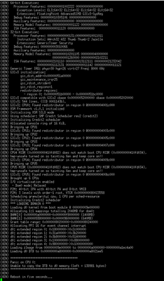

Hello all,
I have a linux downloaded from nxp imx8qm mek LF6 variant, I generated a XEN binary using the yocto for said variant, copied the XEN binary to boot, also copied the imx8qm-mek-dom0.dtb from linux 5.10 to boot. after reset in u-boot I gave this command: run xenmmcboot, and got this ( see attachment )
any ideea how to fix it?

Make sure that the XEN boot is for the device you are trying to boot, looks like is for MX8QX that not correspond to MX8QM.

from the imx8qm yocto i generated the Xen binary, and the dts I took from the linux 5.10 zip file from the same imx8qm mek page.
