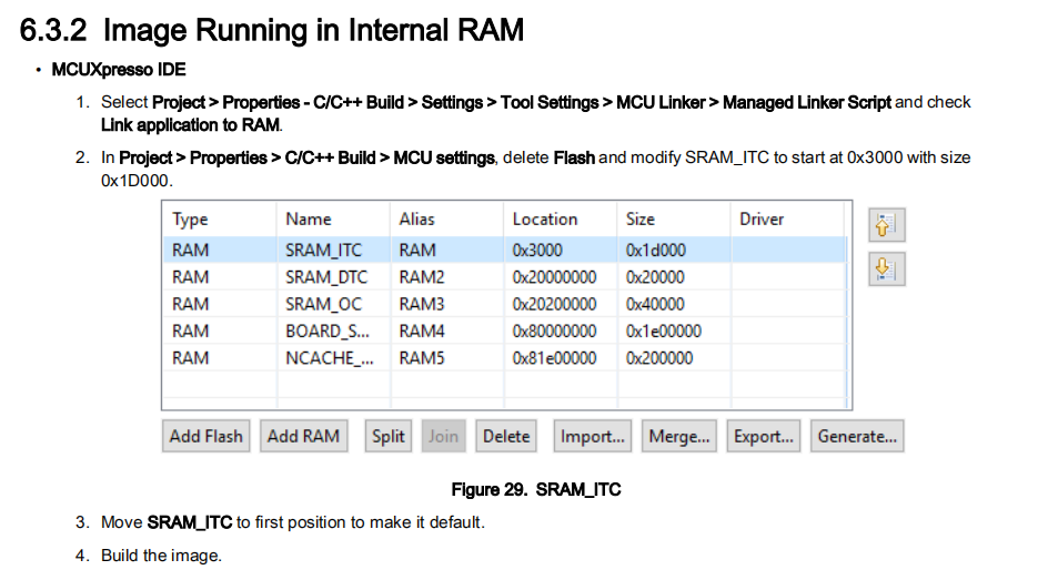

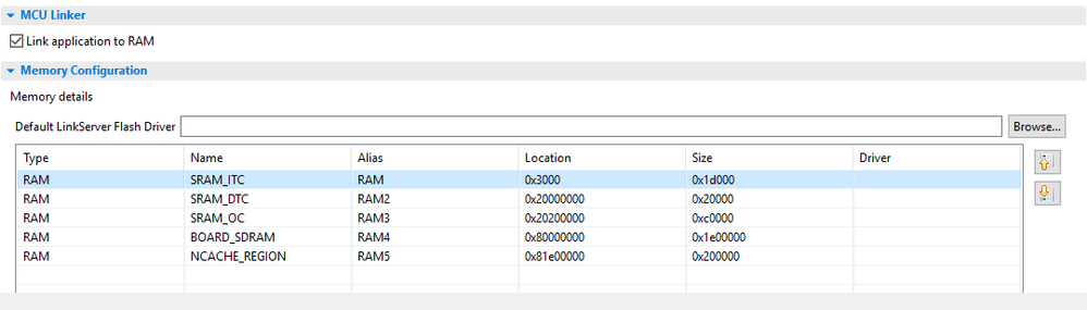

By following the steps provided in "User Manual - MCUXpresso Secure Provisioning Tools" document, I have created the .axf file with the below configuration.,
I have used the "usb_device_dfu_lite" example provided in SDK. After generating the .axf file, I am using the Binary Utilities to generate the .bin file.

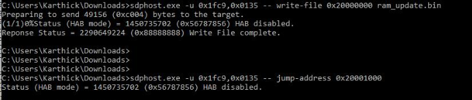

Unfortunately the code did not start execution. I have followed the below steps.,
I used the .bin and .srec files created in the folders "secure_provisioning\bootable_images" and "secure_provisioning\source_images" respectively by using MCUXpresso Provisioning Tool.
I carried out the below commands.,
1) elftosb -f imx -V -c imx_application_gen_win.bd -o evkmimxrt1060_dev_dfu_lite_bm.bin evkmimxrt1060_dev_dfu_lite_bm.srec
 Using the above command, I got the "evkmimxrt1060_dev_dfu_lite_bm.bin" file created using elftosb.
2) sdphost.exe -u 0x1fc9,0x0130 -- write-file 0x0 evkmimxrt1060_dev_dfu_lite_bm.bin
3) sdphost.exe -u 0x1fc9,0x0130 -- jump-address 0x1000

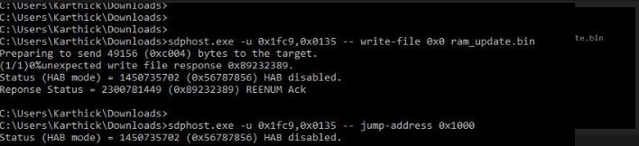

On executing the commands 2 and 3, I got the following Error.
So, I tried with the below commands by changing the address.
1) sdphost.exe -u 0x1fc9,0x0130 -- write-file 0x20000000 evkmimxrt1060_dev_dfu_lite_bm.bin
2) sdphost.exe -u 0x1fc9,0x0130 -- jump-address 0x20001000
On executing the above commands, the stats returned was success, but the device was not enumerated as DFU but falls back to Serial Downloader Mode. This indicates that the DFU program execution is not started.
I have also attached the .bin file created using elftosb  for your reference.

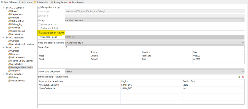

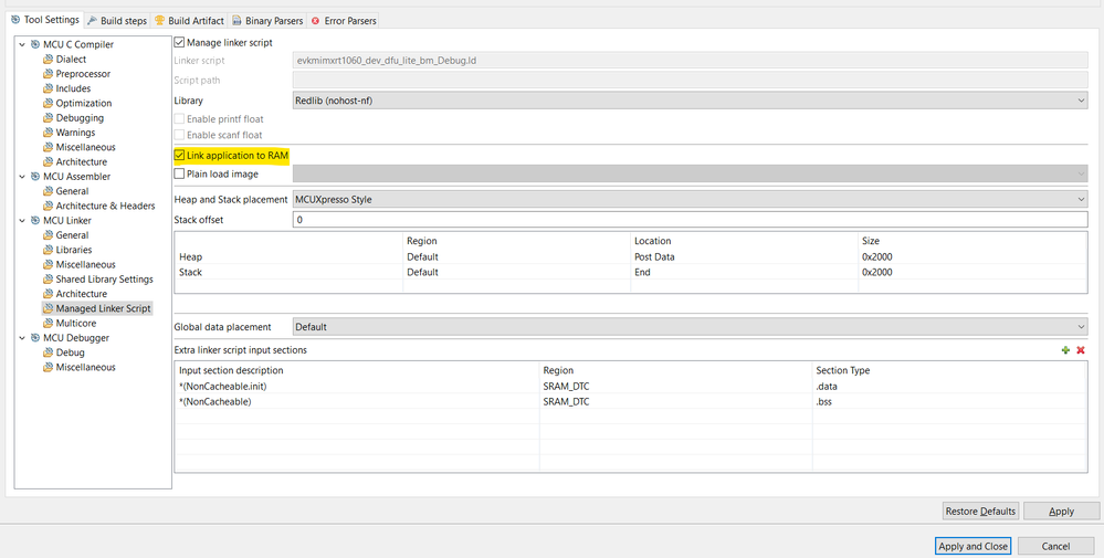

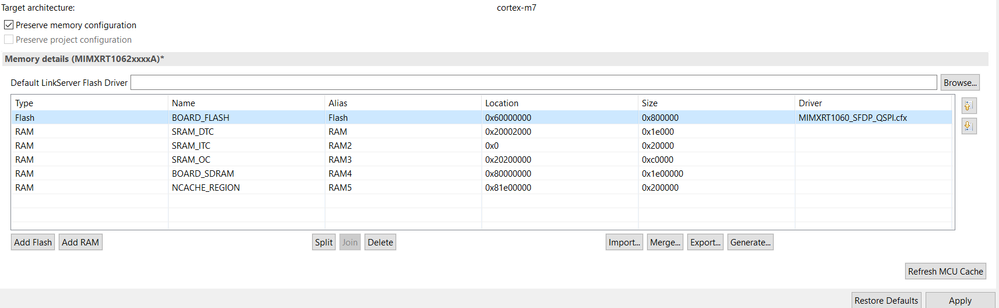

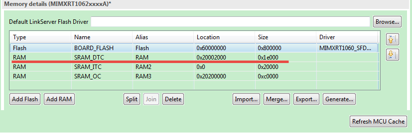

1. Generate bin file
Note: the axf is the image file of my project whose begin address is 0x20002000.
2. Program the bin file to the MCU via sdphost
3 Test
 You can input any character in a terminal tool, the MCU will print the character back, and it also prints this string: "Executing in RAM".
I've attached my project and imx-dtcm-unsigned.bd, please give a try.

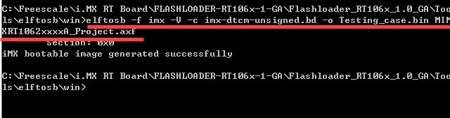

After the .axf file is created, it is converted into .bin file using the command.,
>elftosb.exe -f imx -V -c imx-dtcm-unsigned.bd -o DFU_Example.bin evkmimxrt1060_dev_dfu_lite_bm.axf
>sdphost.exe -u 0x1fc9,0x0130 -- write-file 0x20000000 DFU_Example.bin
>sdphost.exe -u 0x1fc9,0x0130 -- jump-address 0x20000400
After giving these commands, the device fails to enumerate.
