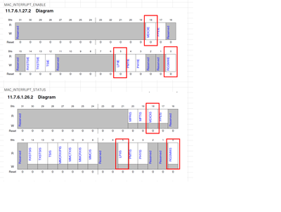

Please check the difference in bit fields in the two registers below.
Then checking the explanation of the bit fields with differences will make your question clear.
George

okuda
Dear George,
Thank you for your reply.
However, I didn't quite understand the meaning of your answer.
The reasons why I couldn't understand it are as follows.
The following source was added to the else side of the if statement in EnetIsr.
DbgPrintEx(DPFLTR_IHVVIDEO_ID, DPFLTR_WARNING_LEVEL, "Spurious Interrupt\n");
RegVal = pAdapter->ENETRegBase->MAC_INTERRUPT_ENABLE.R;
DbgPrintEx(DPFLTR_IHVVIDEO_ID, DPFLTR_WARNING_LEVEL, "MAC_INTERRUPT_ENABLE 0x%08x\n", RegVal);
RegVal = pAdapter->ENETRegBase->MAC_INTERRUPT_STATUS.R;
DbgPrintEx(DPFLTR_IHVVIDEO_ID, DPFLTR_WARNING_LEVEL, "MAC_INTERRUPT_STATUS 0x%08x\n", RegVal);
The log obtained after unplugging the Ethernet cable is as follows.
Spurious Interrupt
MAC_INTERRUPT_ENABLE 0x00000000
MAC_INTERRUPT_STATUS 0x00040021
The attached image shows the two MAC_INTERRUPT registers pasted from the reference manual.
The bit that is set to 1 from the log information is the bit in the red frame in the attached image.
This shows that the bits in the two registers match.
Please provide more details about your answer, including examples
Best regards.
Koji Okuda

JosephAtNXP
Thank you for your interest in NXP Semiconductor products,
Seems like this issue described here.
A workaround would be (as the post says) clearing LPIIS bit.
Then, try to move to disable LPI interrupt.
