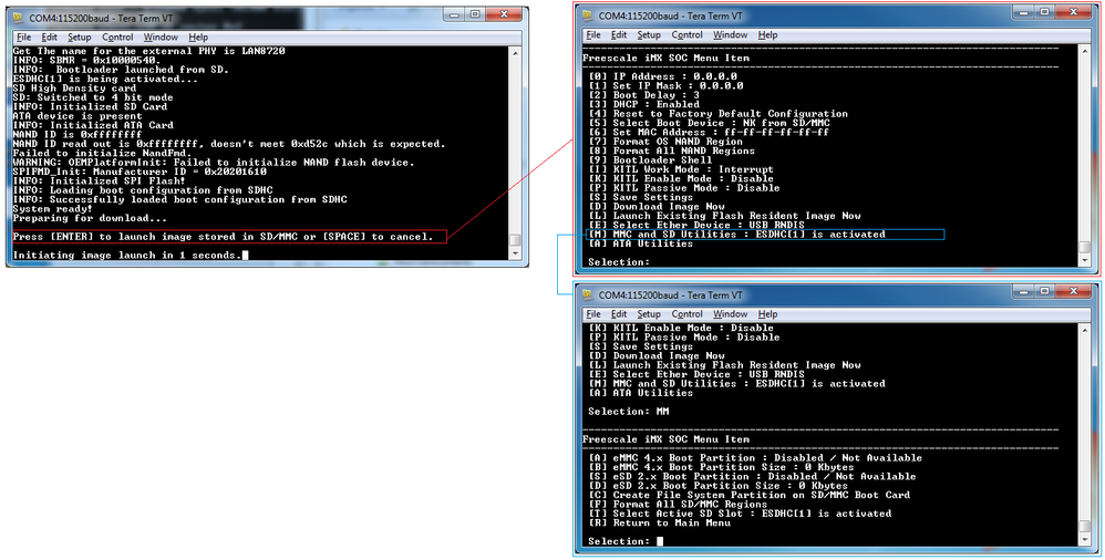

This will get you to a point where the example project is running from the SD card.  If the booting causes a problem, then you may have to hit the space bar and change the boot configuration to be the following:

10. Then - The most important step if you are using SD to boot the OS image - enter yes to allow the Eboot to flash the downloaded OS image onto the boot media. - Never ever use the cfimager to flash the nk.nb0 as what suggested in the user guide as this will never ever work and has wasted 2 days of my time!!! The CFI tool just simply not able to work out where is the correct jump to address.
11. Once it is down - sit back and enjoy watching the Sabre booting up the Win CE7 image - the booting up can take about 20s - Oh yes, before you reboot the system, make sure you select the boot option is to boot from the correct boot media - such as the SD if you have used the imgsdmmc flag in the built environment.
