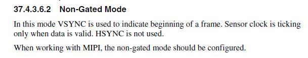

Dear all,
Now I'm working with a mipi camera on imx6 dual lite, after check the RM, I find :
However, I check through the RM file, and find one vsync pin for CSI0 parallel port but no vsync pin for CSI MIPI.
I  wonder if vsync is necessary to make MIPI working ?

Hi If
external vsync signal is not needed, as synchs are embedded in mipi
stream, please check  Table 19-2. CSI2IPU output signals to IPU   vsync,hsync
i.MX6DQ Reference Manual
http://cache.freescale.com/files/32bit/doc/ref_manual/IMX6DQRM.pdf
