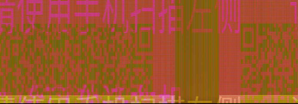

724956014
I take video according shell command "screenrecord --size 1920x720 --time-limit 10 /sdcard/test.mp4", but the video is abnormally, but screencap is normal.1582264548(1).png

Hi ming chen,
Can you please let us know below information:
- i.MX processor
- Linux BSP version
- Yocto Image
Karan Gajjar

Hi ming chen,
We tried on i.MX6Q with Android 9 prebuilts P9.0.0_2.2.0_GA_DEMO_MX6SD and recorded a video with the command that you mentioned "screenrecord --size 1920x720 --time-limit 10 /sdcard/test.mp4". Video played smoothly as expected. If you are using any EVK can you please try with the prebuilts?

Dear [email protected]
Thanks for your reply. In my platform, i.MX processor is i.MX 8qxp, Linux version is 4.4.0-170-generic (buildd@lcy01-amd64-019) and I do not know what is Yocto Image.

Hello Ming,
You are playing a non supported kernel version you might find several screen resolution in latest bsp 4.19.35.
