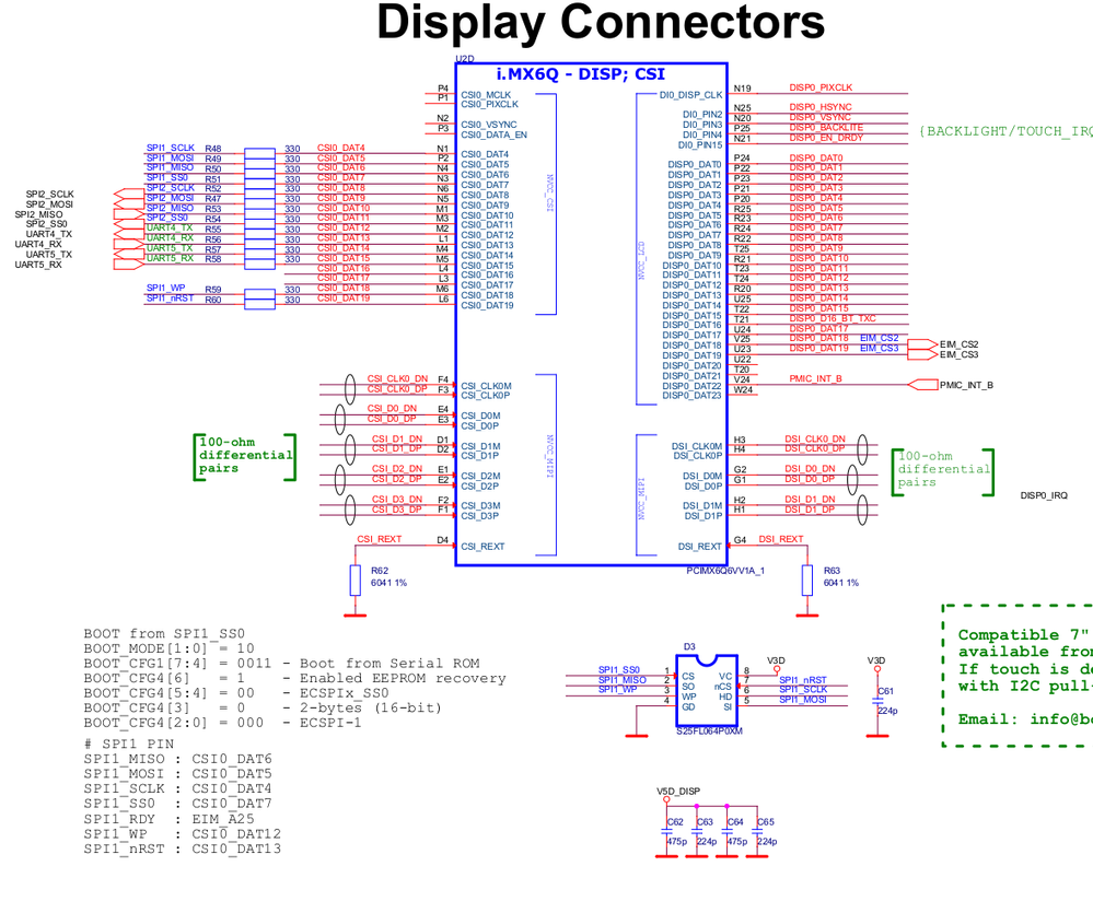

We had designed a custom board based on imx6qsabre-AI , but the nor flash storage the data , the code is

for saving environment parameters in spi-nor please check
definition in uboot/include/configs/*board*.h file :
#define CONFIG_ENV_IS_IN_SPI_FLASH

After testing found that flash memory can be an environment variable, but can not use,such as :

in my uboot/include/configs/borad.h file is such as :
#ifdef CONFIG_SYS_USE_SPINOR
#define CONFIG_CMD_SF
#define CONFIG_SPI_FLASH
#define CONFIG_SPI_FLASH_STMICRO
#define CONFIG_MXC_SPI
#define CONFIG_SF_DEFAULT_BUS  0
#define CONFIG_SF_DEFAULT_CS   1
#define CONFIG_SF_DEFAULT_SPEED 20000000
#define CONFIG_SF_DEFAULT_MODE (SPI_MODE_0)
#endif
but it's the same than I Turn off the power and  restored my save data is not in spi-nor flash
