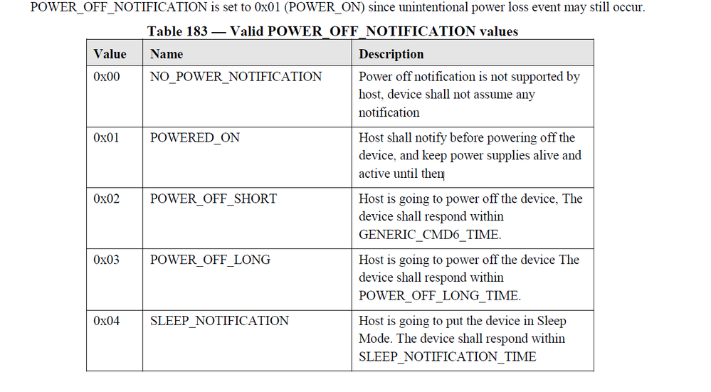

    The i.Mx8DualX board uses function "devb-sdmmc-mx8x()" to manage the emmc driver, which is provided by QNX.  Our new question is : "After executing shutdown_system_with_reason(), will devb-sdmmc-mx8x() send PON instructions to EMMC?

yes, this is the right driver. You just need to start the driver devb-sdmmc-mx8x()  with mentioned parameter "pwroff_notify=[short|long]".
Then, when you call shutdown function, the driver will be closed by system, then the driver should send PON to eMMC during closing.

If you read the linux source code and check the emmc status at runtime.
You will find the linux mmc driver, which is NXP BSP based on, already use Power Off Notification

Here is check on board
root@imx8qxpc0mek:~# mmc extcsd read /dev/mmcblk0
Extended CSD rev 1.7 (MMC 5.0)
Card Supported Command sets [S_CMD_SET: 0x01]
HPI Features [HPI_FEATURE: 0x01]: implementation based on CMD13
Background operations support [BKOPS_SUPPORT: 0x01]
Max Packet Read Cmd [MAX_PACKED_READS: 0x3f]
Max Packet Write Cmd [MAX_PACKED_WRITES: 0x3f]
Data TAG support [DATA_TAG_SUPPORT: 0x01]
Data TAG Unit Size [TAG_UNIT_SIZE: 0x03]
Tag Resources Size [TAG_RES_SIZE: 0x00]
Context Management Capabilities [CONTEXT_CAPABILITIES: 0x05]
Large Unit Size [LARGE_UNIT_SIZE_M1: 0x03]
Extended partition attribute support [EXT_SUPPORT: 0x03]
Generic CMD6 Timer [GENERIC_CMD6_TIME: 0x0a]
Power off notification [POWER_OFF_LONG_TIME: 0x32]
Cache Size [CACHE_SIZE] is 8192 KiB
Background operations status [BKOPS_STATUS: 0x00]
Context configuration [CONTEXT_CONF[39]]: 0x00
Context configuration [CONTEXT_CONF[38]]: 0x00
Context configuration [CONTEXT_CONF[37]]: 0x00
Packed command status [PACKED_COMMAND_STATUS]: 0x00
Packed command failure index [PACKED_FAILURE_INDEX]: 0x00
Power Off Notification [POWER_OFF_NOTIFICATION]: 0x01
