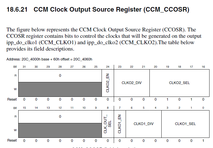

     I'm working on enabling CCM_CLKO2 clock on GPIO3 as described in iMX6 quad manual. I was told I need to enable GPIO3 in bootloader, I assume is in devicetree (.dtsi) files.
Also, I don't know where should I set the CCM_CCOSR register. In the drivers/pinctrl/pinctrl-imx6q.c file ? I see there are defined the padding.
    Where is the correct place to set this iomux configuration ?

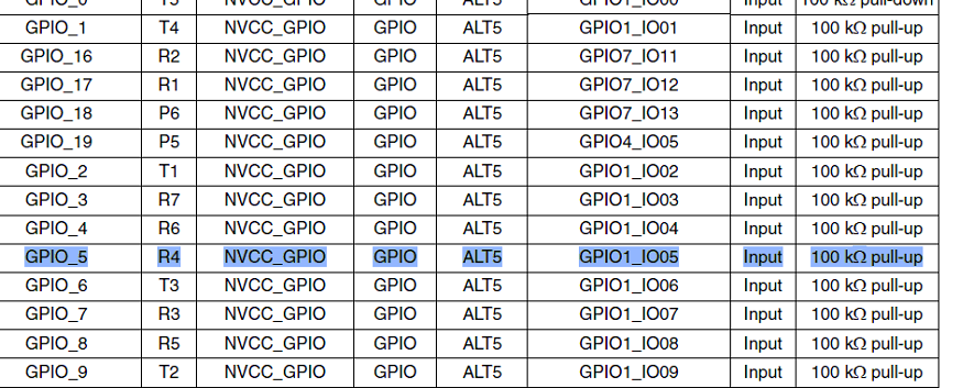

    I can use now memtool, thank you. I  set GPIO 5 mux mode to 0x3 and CCM_COSR register to 0x8e.
   The problem is that I don't know how to connect the GPIO5 to one of 10 GPIO pins available on imx6q for user purpose
in order to export it on the board and put an osclilloscope on it.
    For example, GPIO_5 translates to pin GPIO1_IO05 which is not available to be exported on my board. What should I do in order to have the CLK01 clock set by GPIO5 on my board ?

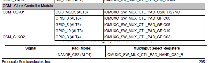

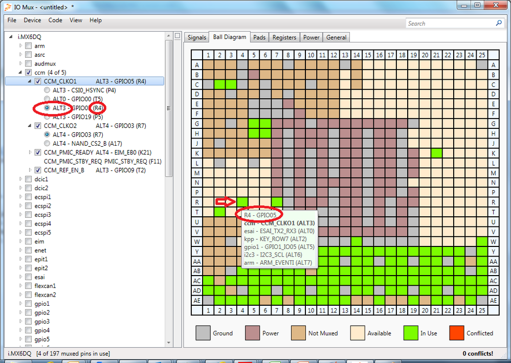

BiyongSUN
In the table 4.2 Muxing Options, already show how to configure the it.
Set IOMUXC_SW_MUX_CTL_PAD_GPIO05 to ALT3.
Please also set the iomux control.
You can get  4.1.1 Pin Assignments.
If you have download the iomux tool, it will be helpful. it will show you even where is the Pin Assignments

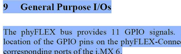

mihaitaivascu
The hardware engineer told me that I need to export the clock on one of 11 GPIOs that can be wired on the board. How can i commute the CCM_CLKO1 signal to one of those GPIOs ?

BiyongSUN
The iomux can wire out the CLKO1 and CLKO2 are listed below. Except those pins, no  pin can connect to the CLKO1 and CLKO2.
Which one below, your hardware engineer said he can wire out ?
4,500 Views

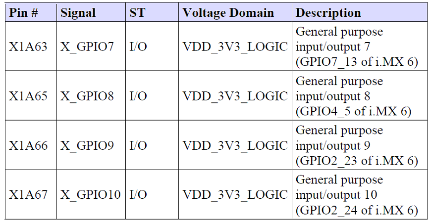

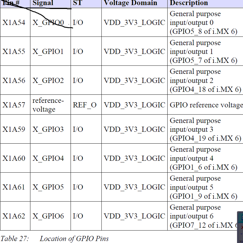

mihaitaivascu
We have this list of available GPIOs that the hardware enginner can route for me on the board so i can measure the CLKO1 clock:
4,500 Views

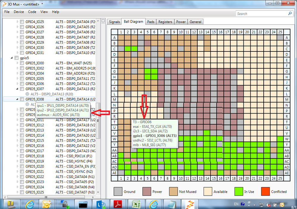

BiyongSUN
I give you an example how to check the GPIO you hardware engineer list.
I readlly could not read you hardware engineer's list.
But you can do, it to use the iomux tool.
As you hardware engineer the ball map the gpio listed to you.
Here is just my guess from your table.
GPIO5_8
See the picture, when you point your mouse to the gpio. or the ball map, the floating note will appear.
It wil show you the function of this pin.  By this way, you can  check if you can find pin for CLKO1 and CLKO2.
And  I have listed the muxing option "Table 4-2. Muxing Options" above already. You just can check if it is in the list that hardware engineer give to you.

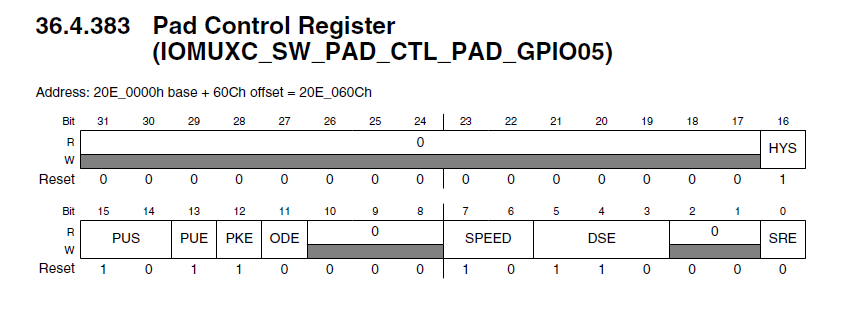

       Thanks for the information. Can I program the padding for other GPIO exactly like for GPIO05 ?
For example: for IOMUXC_SW_PAD_CLT_PAD_GPIO05 i wrote 0x1b0b0 . Can I write the same value for IOMUXC_SW_PAD_CLT_PAD_GPIO19 ?
i would assume yes, as the bit fields are the same.
4,500 Views
BiyongSUN
You write  0x1b0b0 to IOMUXC_SW_PAD_CLT_PAD_GPIO05.
What is the meaning for this pad? You want to use this pad as ALT0  ESAI_TX2_RX3?
Suggest you can read
Chapter 36
IOMUX Controller (IOMUXC)
first.
4,500 Views
mihaitaivascu
i was referring to IOMUXC_SW_PAD_CTL_PAD_GPIOn , not IOMUXC_SW_MUX_CTL_PAD_GPIOn. i know IOMUXC_SW_MUX_CTL_PAD_GPIO5 has to be 0x3
What is the correct value for iomux control ?

According to imx6q manual address of CCM_COSR register is 0x20C4060 but writing to this address directly from a c aplication is not possible. Probably i don't have permission to write there.
So how do you guys configure CCM_COSR register to use ckil_sync_clk_root for CLKO1 ?

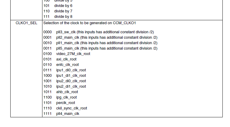

mihaitaivascu
        I have switched to using CLKO1 as this one can use the ckil_sync_clk_root source. So I added in pinctrl_hog_1: hoggrp-1 section of my .dtsi file the necessary pad: MX6QL_PAD_GPIO5__CCM_CLKO1  for which I checked the definition and it multiplexes GPIO5 to CLKO1.
    Now i should set the CCM_COSR register to 0x8e in order to enable CLKO1 and use ckil_sync_clk_root source.
I don't know where should i do this. where do i write the 0x8e value ? Can I do it at command line to /sys/class/gpio/gpio5 ?
