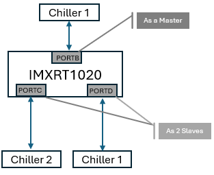

1,  I used the chip's three 485 serial ports to communicate with external devices, One of the serial ports(PORTB) as a Master to request data from external devices, and the other two serial ports(PORTC and PORTD) as a Slave to respond to requests from external devices(As shown below).

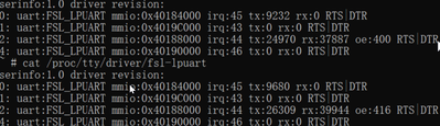

2,  If the baud rates of the three serial ports are set to the same value (e.g.: all are 2400 or 19200 or 115200, etc.), there will be no Overrun error. However, if they are set to different values, the serial port with the higher baud rate will have Overrun errors(As shown below).

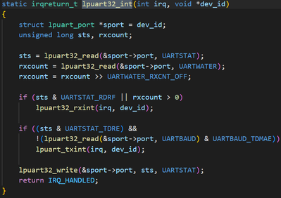

Thank you very much for your reply and support. Could you tell me how to set the priority of the corresponding interrupt in Linux lpuart driver code?
For example: I want to increase the priority of the following interrupt. What should I do after I apply for the interrupt?
Thank you again.
