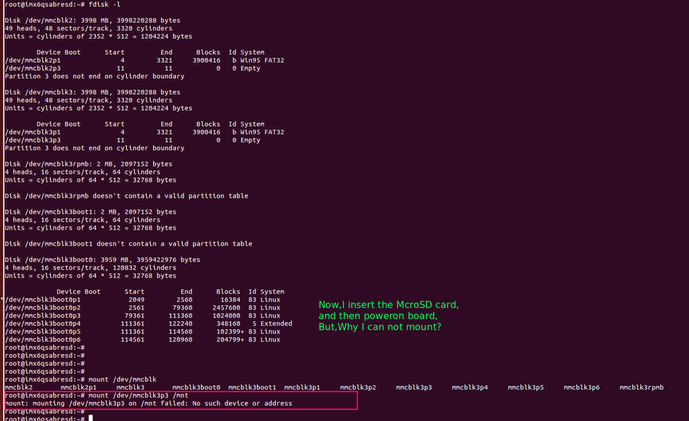

     Today I met one problem,I use Imx6q+yocto+imx-4.1.15-2.1.0+core-image-minimal, burn image with mfgtools.
      When I insert the MicroSd card ,and then reboot ,I can not  mount /dev/mmcblk3p3 ?
    The error scene is below:
      but When i without MicroSD card insert ,and then power on board,it is normal:

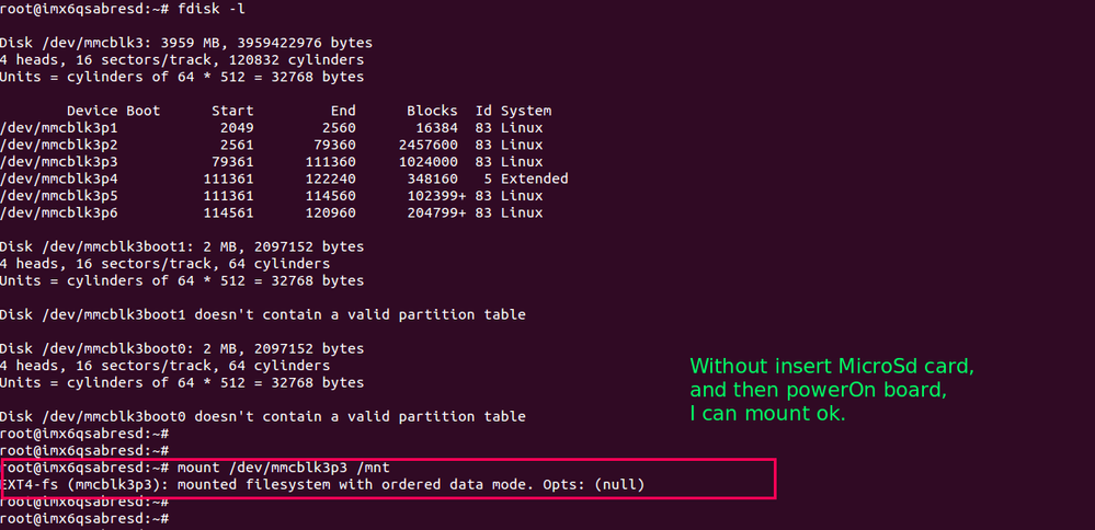

      the scene is:
   and also,When i without MicroSD card insert ,
   and then insertt MicroSD card,
   it is normal also:
   the scene is:
   Anyone Can give me some advices?

Please try to reset SD card with the commands like these
# echo off > /sys/class/mmc_host/mmc3/power/control
# echo auto > /sys/class/mmc_host/mmc3/power/control
to the kernel to see that SD card is attached.
Victor
