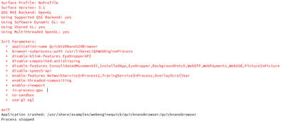

6. Qt Creator open quicknanobrowser and changes the url  to https://threejs.org/examples/#webgl_animation_keyframes
7. Run quicknanobrowser on a Device
Here is the output
Quicknanobrowser executes WebGL and some projects will crash, including changing the url to github
Is it related to the EGL extension support provided by i.MX ?
The same operation does not happen on Raspberry Pi 4, and the comparison excel is attached
