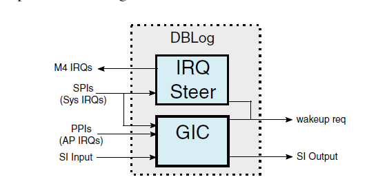

How to configure wakeup source in Cortex-m4 for iMX8QXP/DX.Planning to write mem to /sys/power/state entry and make the system into low power mode. Then need to wake up the system up using interface which is handled in Cortex-M4.
Could you please provide steps to configure wake source to preform the same.

Hi Igor,
Could you please share wake source example with w.r.to CortexM4.
By referring IMXLUG (Rev. L4.14.62_1.0.0_beta, 11/2018 ),I could configure the debug port as wake source as below and it works fine.
echo enabled > /sys/class/tty/ttymxc0/power/wakeup
Some of the interfaces are handled from Cortex-M4 through RTOS.(Say flexcan).I would like to configure CAN as wake source and wake the system.
As part of my experiments I have done below
Step 1 : Configuring the wake source in CAN controller (RTOS configuration)
    • WAKSRC bit to 1
    • SLFWAK bit to 1
Step 2 : echo mem > /sys/power/state in Linux console and made  system to low power mode.
Step 3 : send CAN data to the system
Step 4 : checking wakeup is happened or not Linux - Not waking the system.
I could see in RM that iMXQ8XP interrupt logic are handled by IRQ STEER and GIC.
I feel Cortex M4 interrupts are routed through IRQ steer logic and somewhere.Am I missing the wake source configuration something related same?
Could you please comment and  requesting to share if documentation is available on the same topic.

igorpadykov
Hi Jith
right, from software side it s handled by SCFW: SCFW Porting Kit
I am afraid such codes with w.r.to CortexM4 are not available yet, please note that
i.MX8QXP(DX) is preproduction processor and not officially supported. Also there is no
documentation on this subject. If you have project with such features suggest to
proceed with NXP Professional Services | NXP or apply to local NXP office for special support.
