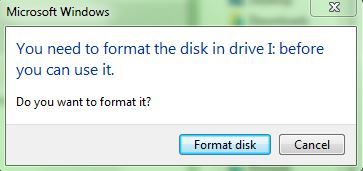

KeshavaGN
Contributor V
Thanks.
Can you please clarify:
1. Whether my understanding is correct about creating binfs mbr? that is using eboot menu... Is there any other tool for this?
2. If I insert the card to Win7 PC (after creating binfs mbr in eboot), I'm getting this prompt to format the card, and if I format it, the binaries will be erased. Is it OK?
7,344 Views
qiang_li-mpu_se
For Q1, yes, no other tool for BINFS MBR.
For Q2, you should not format the card on PC again.
7,344 Views
KeshavaGN
Contributor V
Reg. Q2.
I asked this because, according to eboot MBR utility, it will create 3rd partition as FATFS. But it's not opening on host PC.
7,345 Views
KeshavaGN
Contributor V
And if I insert the card to Win7 PC, I'm getting this prompt to format the card, and if I format it, the binaries will be erased. Is it OK?
7,344 Views
