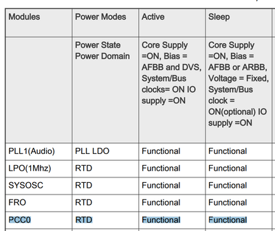

Yes, it should be possible according to Reference Manual, look at chapter 9.1.7 Power mode details (real-time domain):
Manuel_Salas_0-1746466223671.pngManuel_Salas_1-1746466252016.pngManuel_Salas_2-1746466277393.png
As you can see all the necessary components to WDOG0 are available during ARBB mode, but maybe there is the possibility that uPower is gating clock of this WDOG or maybe of entire PBRIDGE0.

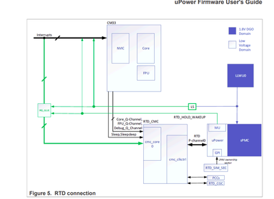

Please take a look to the uPower Firmware User's Guide.

Also, you can check the uPower guide to see the RTD connection:
In few words, at 1.05V / 160 MHz the clocks are fully enabled, there is not forced clock gating and reset system fully clocked.
