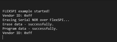

Hello everyone,
I'm using MCUXpresso for VSCode in order to test the peripherals of a custom board similar to imx93-qsb. Starting from the SDK project "flexspi_nor_polling_transfer" I would like to test the functionality of NOR flash MT25QU01GBBB8E12, very similar to the chip used in the example: MT25QU512ABB.
When it comes to the function
flexspi_nor_get_vendor_id it gives 0xFF instead of 0x20, then it completes the last operations successfully.
I'm using the same SPI peripheral of the example (flexSPI1 on SD3 pads), I'don't understand why I'm not reading the ID vendor correctly. Can anyone help me?

2,026 Views
Bob_NXP_user
Yes, I added this code as you suggested:
unfortunately nothing has changed, as you can see:
@AldoG do you have other ideas?
Bob
2,009 Views
AldoG
Thank you for testing, then most likely is that LUT sequence is not correct when READ ID is performed, please try the following change in the LUT:

1,963 Views
Bob_NXP_user
Hello Aldo,
Thanks for helping me. Unfortunately, This change on the LUT is not the solution, I'm still reading 0xff on Vendor ID. I share with you all the entire C code:

1,955 Views
