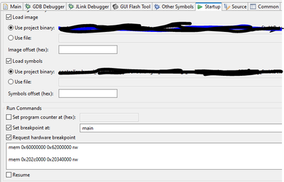

I am facing problems with debugging code using J-link and VSCode extension with iMXRT117x. I am using a custom board without flash - only external RAM is available. With MCUXpresso I was able to establish proper debugging session but with VSCode I have troubles.
First thing that is not working fully correct for me is that J-link settings file is loaded from default location which is in the "build" directory. I can change the settings in the file but my environment work in the way that when I clean project the build directory is deleted so I need to change settings file every time I clean the build. Is it possible to set custom path to the settings J-link file?
Second thing is that to be able properly debug the code I need to add the memory settings. In the MCUXpresso it is done in the way presented below
How can I add this settings to the VSCode debugger?

Hi @Greenhal,
Unfortunately, the two features that you are looking for are not available on the current version of VS Code. Please continue using standalone MCUXpresso IDE instead.
BR,
Edwin.
