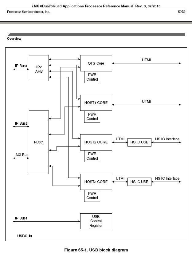

Hello, everyone
I'm using a Freescale SoC (confidential) which has some common points with an IMX6. I'm working under Linux 3.10.17.
This SoC has 3 USB controller (chipidea). The two first are OTG, the third is HSIC.
I modified the driver (drivers/usb/chipidea/ci_hdrc_imx.c, usbmisc_imx.c) to support this chip and its HSIC controller.
When operating in host mode (dr_mode ="host" in DTS), this is OK: a chip SMSC9730 (HSIC to Ethernet) is detected, right driver is loaded, ethernet interface is OK.
My target application is to use this SoC as a HSIC peripheral.
I connected my board through HSIC to an other board set as a HSIC host.
I set my board in peripheral mode (dr_mode = "peripheral" in DTS).
I load module g_ether and nothing happens on host board: no detection of RNDIS/Ethernet gadget.
Did someone already use USB-HSIC in peripheral mode ?
Can someone suggest a way to setup a HSIC peripheral ?
Can anybody help me?

Thank you for this answer. But I am not working with iMX6 which has host-only HSIC controllers.
I'm working with an other Soc which is confidential (NDA) which one of its USB controller is HSIC controller. It is a dual role device which can be configured to act as Host or Device through firmware interface. It is not a true OTG controller.
I used it as host or as peripheral by selecting dr_mode in Device-tree.
In the iMX family or other NXP SoC , does it have a HSIC dual-role controller ?

igorpadykov
currently iMX family does not have a HSIC dual-role controller.
2,906 Views
igorpadykov
Hi Didier
unfortunately i.MX6 does not support USB-HSIC in peripheral mode
as its OTG controller does not have connection to HSIC port, so
its linux driver seems also does not support that mode.
igor
