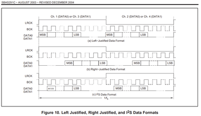

Hello, I'm running RT1024 on a custom board.
SAI1 is configured as an I2S master to control 1 PCM4104. This DAC is capable of driving 4 output channels, it drives 2 channels per logic state of LRCK:
when LRCK is high, CH1 reproduces whatever comes to DATA0 and CH3 reproduces whatever comes to DATA1.
I'm trying to play sounds taking the "evkmimxrt1024_sai_interrupt_transfer" example and changing SAI3 to SAI1 with the next configuration:
The routine is as follows:

2)I see the audio data coming out from TX_DATA0 but not from TX_DATA1. How could I get data to come out from TX_DATA1 pin too?
I've attached the main programming code files for further detail.

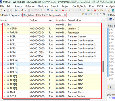

I have download your code, but there are no LED1,LED2,LED3 definition.
when the project freezing, Please check Register, Fault, Peripherals->SAI status.
You can also read SAI status in your code project.

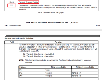

Answer: If you want to use TX_DATA0 and TX_DATA1 of SAI1 , please refer to the content of Section 34.5.1.7 "Transmit Configuration 3 (TCR3)" in the MIMXRT1024RM. You should set the Transmit Enable (TCE) bit in Transmit Configuration 3 (TCR3) when initializing the SAI1.
Wish it helps you.

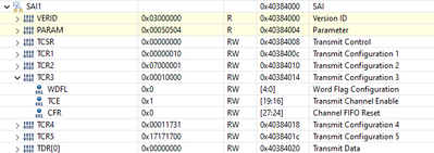

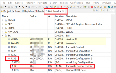

mayliu1
Hi @DigitalBrain ,
Thanks for your reply.

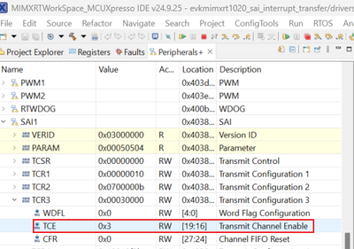

Could you check your SAI1 TCR3 register value.
You can check MCUXpresso IDE -> Peripherals -> SAI1 -> TCR3->TCE
Wish it helps you.
mayliu
3,014 Views
DigitalBrain
Hello, @mayliu1
Thanks for your reply. These are the values:
TCE is set to 0x1.
Maybe I need to use a different function to transmit through TX_DATA1?
Currently I'm using:
sai_handle_t txHandle = {0};
sai_transfer_t xfer;
SAI_TransferSendNonBlocking(SAI1, &txHandle, &xfer);
I understood this function would send the same data at the same time through all the enabled TX_DATA channels. Is it correct?
Thanks!!
3,002 Views
mayliu1
Hi, @DigitalBrain
Thanks for your update information.
I notice that your TCE is 1,  I don't think it is a right value.
TCE should be 0x03(0b0011) if you want both channel1 and channel 2  working.
Please double check your config function.
mayliu

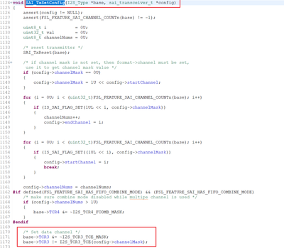

DigitalBrain
Hello, @mayliu1
That's true. I've set it to 3:
SAI_TxSetChannelFIFOMask(SAI1,3);
but after executing the function, the register gets set to 0x1 instead of 0x3.
For some reason, I'm not being able to set it to 0x3
2,996 Views
DigitalBrain
Furthermore, even placing the value directly to 0x3 gets 0x1 as result
void SAI_TxSetChannelFIFOMask(I2S_Type *base, uint8_t mask)
base->TCR3 &= ~I2S_TCR3_TCE_MASK;
base->TCR3 |= I2S_TCR3_TCE(0x3);
2,978 Views

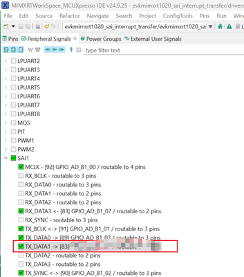

mayliu1
Hi @DigitalBrain
I did a validation on my side, I can set TCE as 0x03, Please refer to what I did.
1: First , I think you should set your SAI  TX DATA1 .
Please note that the GPIO TX DATA1  is not real connect, your code should be based on your customed board. The modified configurations I made are just for giving you a demonstration. Please develop your code strictly base on your customed board.
2: Second, you need call SAI_TxSetChannelFIFOMask(DEMO_SAI, 0x03) in your project
I import SDK demo "evkmimxrt1020_sai_interrupt_transfer" , and use MIMXRT1020-EVK board .
Wish it helps you.
If you have other question, Please create a new case, Thanks.
mayliu

mayliu1
Hi @DigitalBrain
I think DEMO_SAI_CHANNEL depend on your needs, what I show you is just a demo.
You can also set saiChannelMask, this param can also set multiple SAI channel.
function -> SAI_TransferTxSetConfig will call SAI_TxSetConfig
In SAI_TxSetConfig function , saiChannelMask  set TCR3 register.
mayliu
