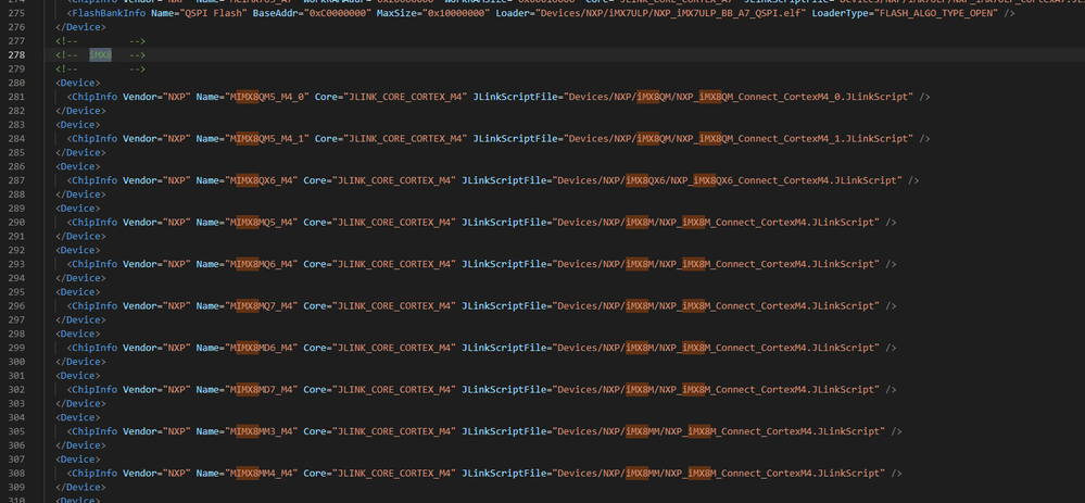

markind
Looks like newest segger jlink versions as of 6.46 have support for MIMX8MQ6_M4

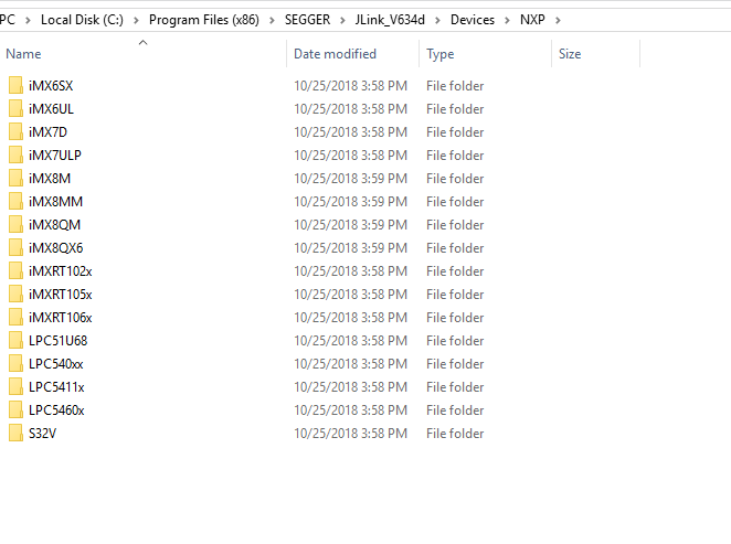

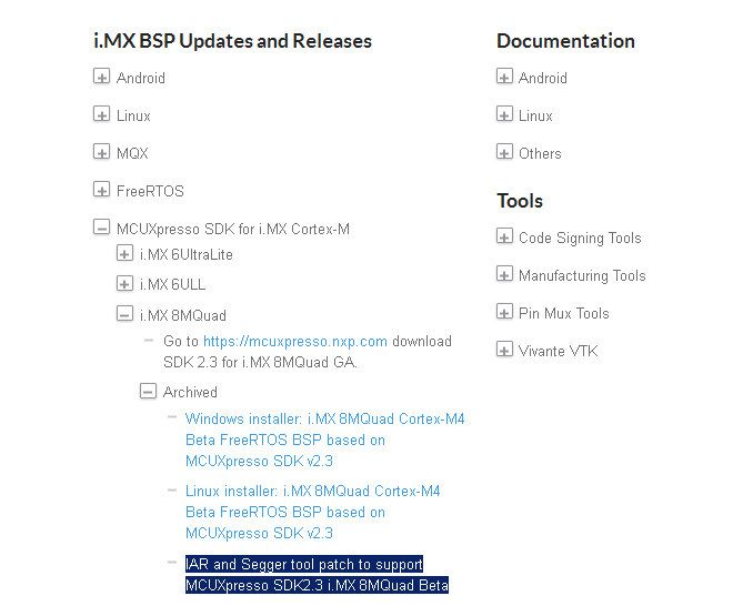

igorpadykov
Hi Quyen
it is available on
i.MX Software|NXP
igor
7,480 Views
quyenngo
I tried to apply this patch by it did not work.
There is not MIMX8MQ6_M4 in the device list.
I tried GDB-sever with Linux host too, but it said that it can connect to the device.

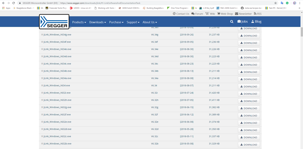

quyenngo
Please answer all of my questions. I have to wait for a long time to get the answer from you. So, please.
1, The patch which I download from your suggestion link is JLINK-V633d, I cannot find the link to download this version on Segger site:
SEGGER - The Embedded Experts - Downloads - J-Link / J-Trace

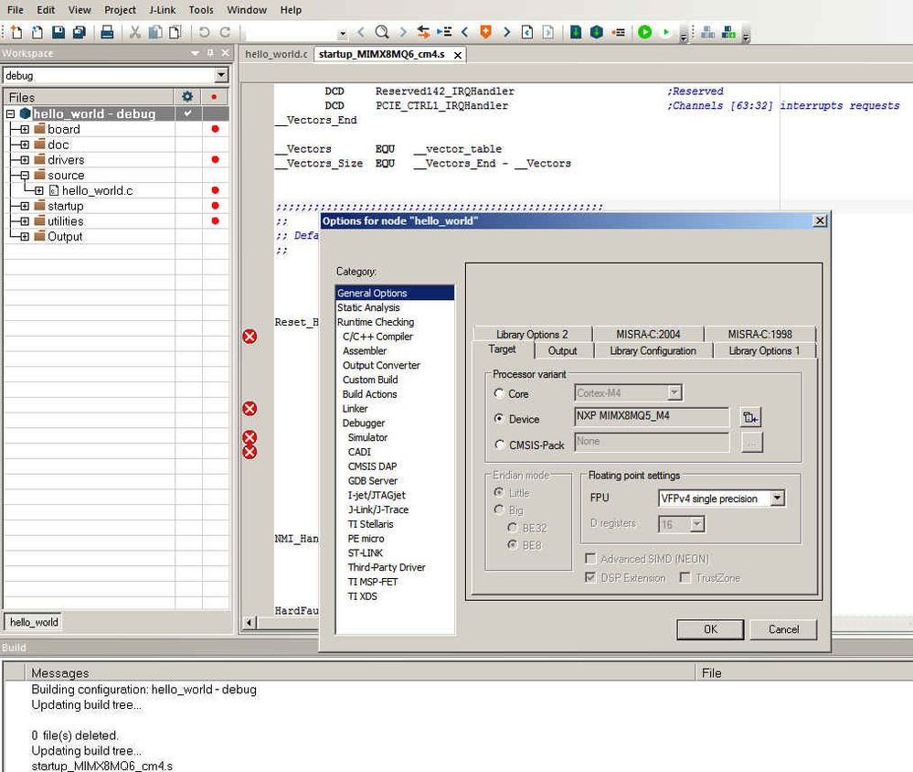

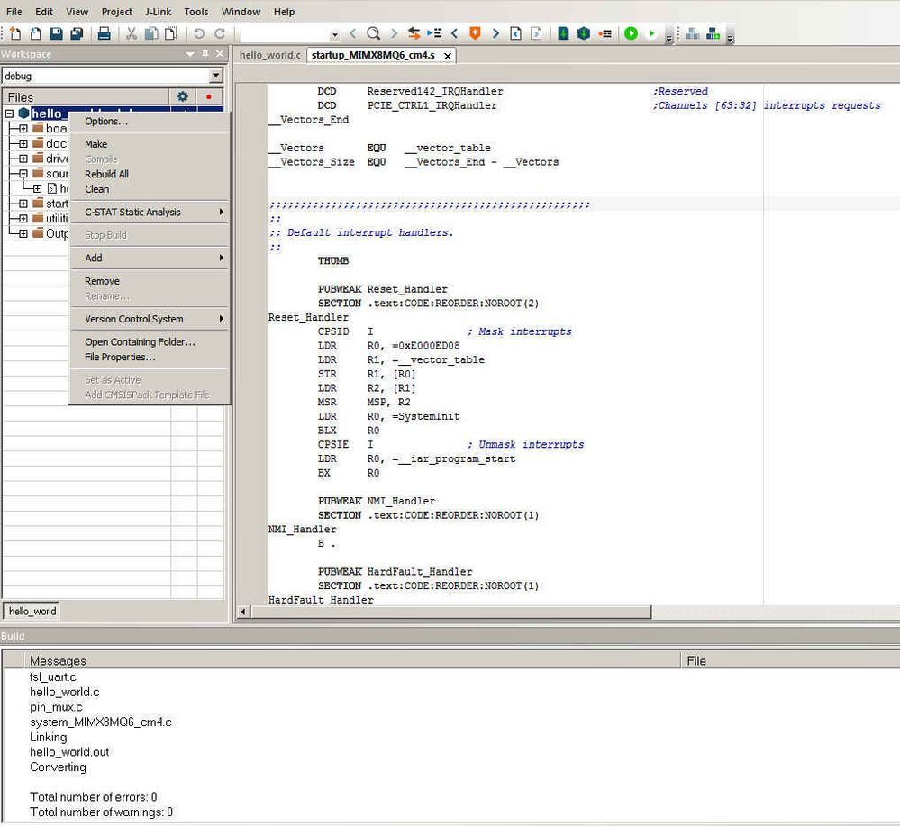

igorpadykov
I just tested "hellow world" with IAR 8.20.2 and it builds well, please
recheck project configuration (right click mouse on project "options") below
