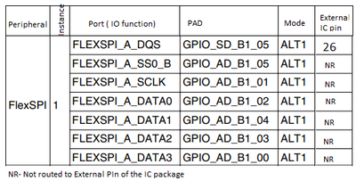

1 )  We are planning to use on-chip SIP 4M Flash Memory for booting the MIMXRT1024CAG4B. Based on the reference manual IMXRT1024RM chapter9, we are assuming that  FlexSPI Instance 1 refers to on-chip SIP 4M Flash Memory .please refer attached image for details and conform on our understanding.
2) With Reference to reference manual IMXRT1024RM chapter9 & 22, the Boot setting BOOT_CFG1[7:4]=[0000]b refers to  Serial NOR boot via FlexSPI. We assume this is nothing but the on-chip SIP 4M Flash Memory. Please Conform our understanding.

1) You're correct.
2)Yes, setting this field to 0s will configure the chip to boot from the on-chip Flash.

4) Unfortunately, this is not possible. You are able to use FlexSPI flash to store data but you cannot use the other flexspi instance to boot. You are able to boot from FlexSPI only on-chip flash.
