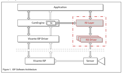

We have managed to write a functional driver for AR0821 for ISI and ISP.
We want to be able to use the Auto-exposure engine (3A in CamEngine) mentioned in the Sensor Porting User Guide
Unfortunately, I am having trouble finding the relevant guide.
Do you know where this guide would be? I've found an interesting structure (vvcam_ae_info_t ) in i.MX 8M Plus ISP Independent Sensor Interface API Documentation, but since we are not using the ISI I'm not sure it's relevant.
Does the included AE engine support higher-order HDR? vvcam_ae_info_t includes hdr_ratio, but our sensor can do up to 4 exposures
Thank you for your help,
