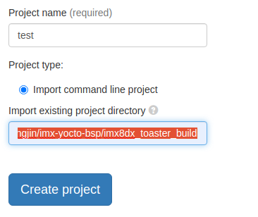

Hi everyone,
Today I use the toaster in the yocto project in the imx8dxmek.
1.According the imx yocto linux user guide,I install the yocto environment.
2.run                DISTRO=fsl-imx-wayland MACHINE=imx8dxmek source imx-setup-release.sh -b imx8dx_toaster_build
3.run                 source toaster start
4.In the webbrowser ,set the http://localhost:8000/
5.click the newproject in the top right corner.
6.Project name is test ,enable Import command line project,the exist project directory is /home/zenghongjin/imx-yocto-bsp/imx8dx_toaster_build,then click create peoject
7.Now I get the error message

Exception Type: DoesNotExist at /toastergui/newproject/
Exception Value: Release matching query does not exist.
How to resolve the problem?Who can give me some advice?
Thanks.

Hello hongjinzeng,
Toaster is not supported by the i.mx8 BSP as of today. You may be able to get it running on the Community BSP as it’s part of the Yocto project but in my experience the way the layers are handled makes it not to work.
