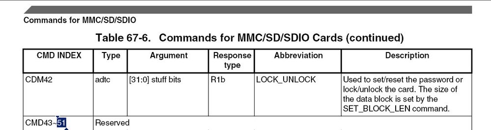

igorpadykov
please read part of RM below
~igor
3,137 Views
zoechen
Hi Igorpadykov,
     Thanks for you reply first, there is some mistake in my description. It should be ACMD 51, get the value of SCR register.
BR,
Zoe
3,137 Views
igorpadykov
amcd51 is "application specific" command, not all cards may support it,
~igor
3,137 Views
zoechen
Yes, so I test my card in SD2 first, I am sure my card support ACMD51, but I can not use this card in SD1.
BR,
Zoe
