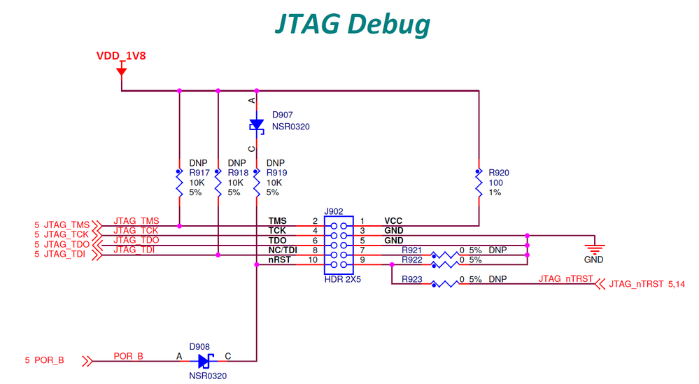

I've been reading about the JTAG debug capabilities of the 8M Mini, and I had some questions about the JTAG Debug port on the 8M Mini EVK. Please see a schematic image below:
Here are my questions:
1. Was this pin header designed to interface with any specific JTAG controller? Or was it just chosen randomly as a way for these signals to come out to pins?
2. Why is POR_B connected to one of these pins? I thought that JTAG only needed TMS, TCK, TDO, and TDI (with nTRST optional)? Does connecting to POR_B offer some kind of easier or additional control?
3. Why is JTAG_nTRST not connected to the JTAG Debug interface? Does the processor use this signal in debug or boundary scan mode?
4. Is VDD_1V8 connected to pin 1 through a 100ohm resistor to allow a JTAG controller to sense the target voltage? Or is connected there for another purpose?

  Please look at my comments below.
1.
  According to section 2.14 [JTAG connector (J902)] of the EVK Board Hardware User's Guide:
The i.MX 8M Mini applications processor has five JATG signals on the dedicated pins and one hardware
reset input signal (POR_B). Those signals are directly connected to the 10-pin 1.27-mm JTAG connector
J902. The five JTAG signals used by the processor are:
• JTAG_TCK—TAP clock
• JTAG_TMS—TAP machine state
• JTAG_TDI—TAP data in
• JTAG_TDO—TAP data out
• JTAG_nTRST—TAP reset request (active low)
https://www.nxp.com/webapp/Download?colCode=IMX8MMEVKHUG
  The JTAG connector is based on standard ARM 10 pins Cortex Debug Connector.
http://infocenter.arm.com/help/topic/com.arm.doc.faqs/attached/13634/cortex_debug_connectors.pdf
http://www2.keil.com/coresight/coresight-connectors/
2.
  The i.MX8Mm POR allows to fully reset i.MX8Mm if needed.
3.
  JTAG_nTRST signal is part of JTAG interface and can be used for Boundary Scan.
4.
  Correct - VDD_1V8, connected to pin 1 through a 100ohm resistor allows a JTAG
controller to sense the target voltage.
Yuri.
