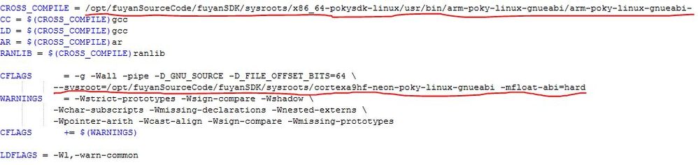

I have downloaded and built Freescale release L4.1.15_2.0.1_ga yocto project
Now,i want to compile udev-90 to realize automatic mounting.
I try to modify the original Makefile in udev-90(dir),but some unbelievable following errors stoped me ruthlessly.
I need your help, my dear friend.
Error:
/opt/fuyanSourceCode/fuyanSDK/sysroot/x86_64-pokysdk-linux/usr/libexec/arm-poky-linux-gnueabi/gcc/arm-poky-linux-gnueabi/5.3.0/real-ld:cannot find crt1.o:No such file or directory
/opt/fuyanSourceCode/fuyanSDK/sysroot/x86_64-pokysdk-linux/usr/libexec/arm-poky-linux-gnueabi/gcc/arm-poky-linux-gnueabi/5.3.0/real-ld:cannot find crti.o:No such file or directory
/opt/fuyanSourceCode/fuyanSDK/sysroot/x86_64-pokysdk-linux/usr/libexec/arm-poky-linux-gnueabi/gcc/arm-poky-linux-gnueabi/5.3.0/real-ld:cannot find crtbegin.o:No such file or directory
/opt/fuyanSourceCode/fuyanSDK/sysroot/x86_64-pokysdk-linux/usr/libexec/arm-poky-linux-gnueabi/gcc/arm-poky-linux-gnueabi/5.3.0/real-ld:cannot find -lgcc
/opt/fuyanSourceCode/fuyanSDK/sysroot/x86_64-pokysdk-linux/usr/libexec/arm-poky-linux-gnueabi/gcc/arm-poky-linux-gnueabi/5.3.0/real-ld:cannot find -lgcc_s
/opt/fuyanSourceCode/fuyanSDK/sysroot/x86_64-pokysdk-linux/usr/libexec/arm-poky-linux-gnueabi/gcc/arm-poky-linux-gnueabi/5.3.0/real-ld:cannot find -lc
/opt/fuyanSourceCode/fuyanSDK/sysroot/x86_64-pokysdk-linux/usr/libexec/arm-poky-linux-gnueabi/gcc/arm-poky-linux-gnueabi/5.3.0/real-ld:cannot find crtn.o:No such file or directory
/opt/fuyanSourceCode/fuyanSDK/sysroot/x86_64-pokysdk-linux/usr/libexec/arm-poky-linux-gnueabi/gcc/arm-poky-linux-gnueabi/5.3.0/real-ld:cannot find crtend.o:No such file or directory
Makefile (red line part is added by me)

Hello Yang Lv,
This error looks a bit like the one described on the following thread:
https://community.nxp.com/thread/329263
However, in this case you seem to be using a the right path for the sysroots and the cross compiler but I would recommend making sure that a simple Hello World can be compiled. Are you using the toolchain from the L4.1.15_2.0.1_ga BSP?
