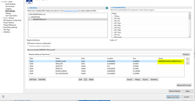

I modified the xxxx_flexspi_nor_config.c file as suggested by other forum postings and Application note files (please see attached)

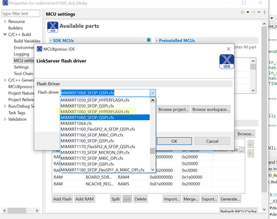

I modified the MCUXpresso properties Driver setting as suggested by Forum suggestions:
When I attempt to program a simple GPIO LED sample code using the GUI Flash Tool the console output is:

3. then you can test the simple led_blinky project, about the .cfx, you can use this one, if you are using the on board CMSIS DAP debugger:
Wish it helps you!

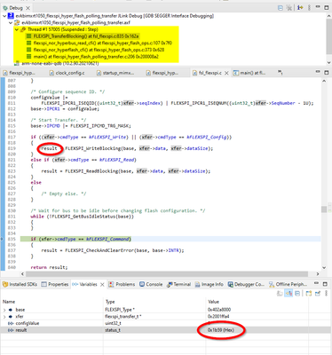

When running the test, I receive and error on the following API call:
static status_t flexspi_nor_hyperbus_read_cfi(FLEXSPI_Type *base, uint32_t addr, uint32_t *buffer, uint32_t bytes)
flexspi_transfer_t flashXfer;
status_t status;
flashXfer.deviceAddress = addr * 2;
flashXfer.port = kFLEXSPI_PortA1;
flashXfer.cmdType = kFLEXSPI_Read;
flashXfer.SeqNumber = 1;
flashXfer.seqIndex = HYPERFLASH_CMD_LUT_SEQ_IDX_READDATA;
flashXfer.data = buffer;
flashXfer.dataSize = bytes;
status = FLEXSPI_TransferBlocking(base, &flashXfer);
if (status != kStatus_Success)
return status;
return status;
with the status == 0x1B59
I stepping into the code to determine what/were the error is coming from.
4,335件の閲覧回数
tbiberdorf
Hi Kerry
I've stepped into the code and got the following, not sure if you can explain.
