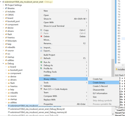

2. build the ota_mcuboot_server_enet with MCUXpressoIDE, and generate the bin file;

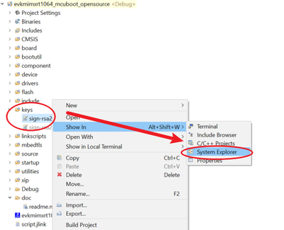

Sure. Signing an image requires the files sign-rsa2048-priv.pem, sign-rsa2048-pub.pem, original image bin ,as well as the imgtool tool.
1. pem file: Find in this folder and copy it to the imgtool folder:
2. bin image file: create the bin file and rename it to server_v1_original.bin , then copy&paste it to the imgtool folder:
