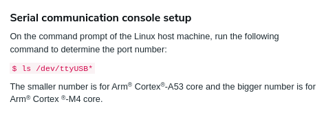

I have connected micro USB cable  between the  debug port (J901) and my PC running linux.
The boot logs plus u-boot are open on /dev/ttyUSB1 and I was expecting the m4 prints to be on the other  serial port i.e. /dev/ttyUSB0 as per the user guide.
I have tried following the User Guide you are talking about and have failed to flash the board, encountering errors since the document written feels incomplete and inaccurate.

Please refer to  1.3 Connect USB Debug Cable in Get Started with the i.MX 8M Mini EVKB for the USB Debug connection in i.MX8MM EVK.
Please Try with /dev/ttyUSB2.

The two serial ports getting detected in my case are /dev/ttyUSB0 and /dev/ttyUSB1.
But contrary to the document you have linked, the boot logs of A53 are being displayed on the serial port with the bigger number i.e. /dev/ttyUSB1.
So I was expecting the m4 logs to be on the other serial port i.e. /dev/ttyUSB0.
And there are no m4 output prints on the /dev/ttyUSB0 when I boot the m4 core.
Thomas
