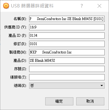

greatshow_chen
My own experience is that you need two usb filters for your device. I don't have screen capture with English interface. You may check the label of hot key in each field compared to the usb redirect settings in you virtualbox settings.
This device is detected once you have install a workable google usb gadget driver. I use the one from boundary device: https://boundarydevices.com/android-tools-windows-support-nitrogen-platforms/

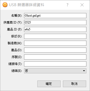

Another one seems appears when the device changes to fastboot mode
I call it ghost gadget since I don't know why it appeared and what is it?
When you use the uuu tool, it seems the device disconnect one time, so you need to reconnect the device from the device dorpdown list of virtualbox window.
**IMPORTANT**
Since the NXP fellow says the image deployment by a virtual machine is not supported officially, take your own risk. And it's better to have a native linux box or flash your image in your windows system.
