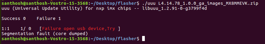

I have come across an error while I'm trying to download the pre-built image using UUU in I.MX8MMini. Please find the error screen shot attached. Kindly advice, How to proceed aheadIUUU_error.pngdmesg_error.png
~/Desktop/flasher$ ./uuu L4.14.78_1.0.0_ga_images_MX8MMEVK.zip
uuu (Universal Update Utility) for nxp imx chips -- libuuu_1.2.91-0-g3799f4d
Success 0    Failure 1
1:1    1/ 0   [Failure open usb device,Try ]
Segmentation fault (core dumped)
Dmesg Command Trace
[   71.268355] usb 1-1: Product: SE Blank M845S
[   71.268356] usb 1-1: Manufacturer: NXP      SemiConductors Inc
[   71.269278] hid-generic 0003:1FC9:0134.0004: hiddev1,hidraw3: USB HID v1.00 Device [NXP      SemiConductors Inc  SE Blank M845S ] on usb-0000:00:14.0-1/input0
[  148.678630] pcieport 0000:00:1c.0: AER: Corrected error received: id=00e0
[  148.678647] pcieport 0000:00:1c.0: PCIe Bus Error: severity=Corrected, type=Physical Layer, id=00e0(Receiver ID)
[  148.678662] pcieport 0000:00:1c.0:   device [8086:9d14] error status/mask=00000001/00002000
[  148.678671] pcieport 0000:00:1c.0:    [ 0] Receiver Error         (First)
[  152.693370] uuu[2579]: segfault at 562e62872a60 ip 0000562e62872a60 sp 00007efe2e0547f8 error 15

1)refer to your error message, it seems your PC don't recognize your imx8mm board, pls check if your PC recognize your board or not
2) for how to uuu tools, pls refer to the user guide,  you should use the command like "./uuu uuu.auto", uuu.auto is the script, don't add demo image after ./uuu

Thanks the USB package had broken, I reinstalled  the package and updated. The issue got resolved
