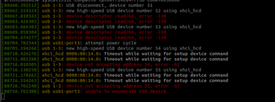

I'm getting same issues with the 8MNANOD4-EVK, with a Ubuntu22 as host machine and with HID decetion with lsusb, in fact, i can run
sudo uuu -v LF_v6.1.1_1.0.0_images_IMX8MNEVK/uuu.auto-imx8mnevk
And if no USB HID is connected the screen remainds as
Until the usb is connected,
The Dmesg shows as HID usb is recognized
Unfortunately this not happend if you try re-pluging the download usb after uuu error
The Debug OTG connection with imx8mnEVK show a uboot error related with DDR
Any advice on how to handle this? It happens in the same way following the generation of images through Yocto.
