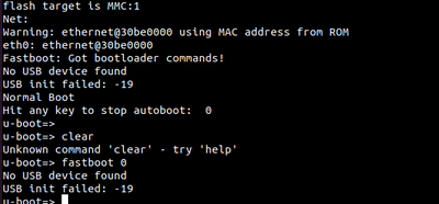

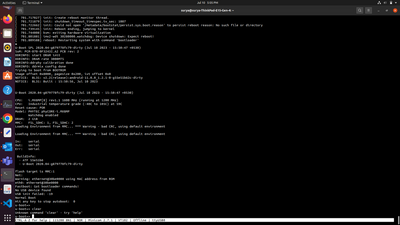

Hi NXP Community,
Iam currently working on fastboot for imx8mp board phyboard pollux board, but whenever i try to unlock the bootloader it return an error message i will attach screen shots below to better describe my problem here,
whenever i try booting from u-boot i get some other error messages like "usb init failed -19"
please find the attached images to better understand the problem
my goal is to flash images to the board in fastboot mode

Hi @venu_mos
The second attached image ambiguous, and the first is part of log.
As below are your scenarios?
Solved: [IMX8MP] uuu download stuck and "USB init failed: ... - NXP Community
Re: iMX8MQ UUU tool error - NXP Community
Solved: MX8MM won't enter fastboot mode - NXP Community
And refer to the attachment for a patch which enable uuu on none type c board.
