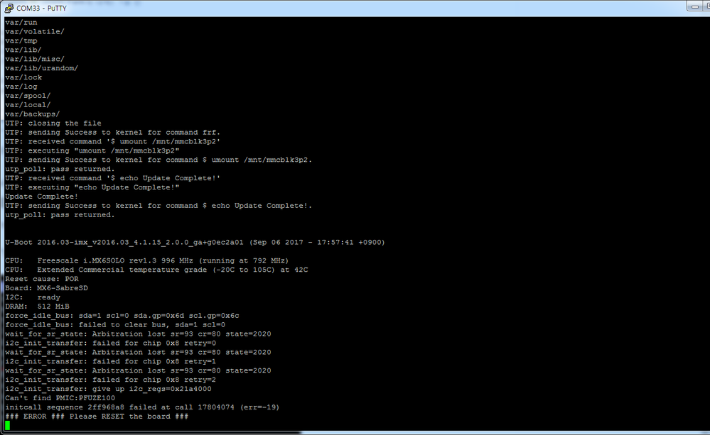

Thank you for your reply.
I modified the "imx6qdl.dts" file as below
I could build the kernel image and then I tried to do porting, but porting was stopped while u-boot booting as below.
Could you give me more advice?
3,335件の閲覧回数
coilnpark
U-boot problem was my fault.
Anyway, I tried to change dr_mode = "host" and ""peripheral" but they are not working.
