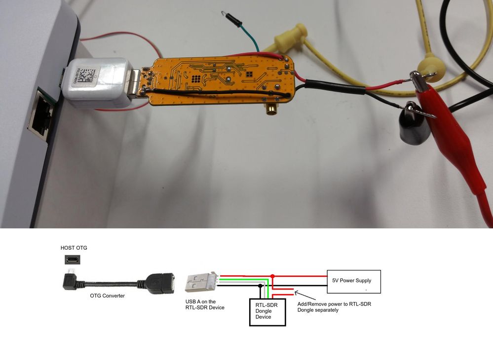

First of all a little bit of context. I have a device that has just one USB port with a micro USB connector. This port is used for serial flashing and when the device is operating normally nothing is connected to this micro USB connector except for the power supply of the device.
We recently discovered that we need to connect an RTL-SDR dongle to this device but we can't perform any modifications to the already existing hardware, therefore I thought that I could just provide power to this device through the USB power pins and provide the RTL-SDR dongle data trough the D+ and D- pins of that same connector.
This is not a standard setup because normally, the USB HOST is the one providing power to the USB device when it is connected to the HOST in an OTG configuration.  But in this scenario, it has to be the other way around and I don't know if this is causing the problem in the first place. I assume that this is not the problem because it is transparent to both devices, or is it?
Since there is no device that provides power to the host I had to hardware-hack a little bit and I have the following:
That way I can provide power to both HOST and DEVICE and also I can remove the power from the DEVICE if needed.

igorpadykov
Hi Manuel
one can set mode is software using sect.39.3.8 Changing the Controller Operation Mode
attached Linux Manual, from hardware check processor USB_OTG_VBUS, USB_OTG_ID
(should be low in host mode).
igor

m4l490n
Contributor V
Thanks! that helped.
I just added dr_mode = "host"; to my device tree and that solved the problem.
