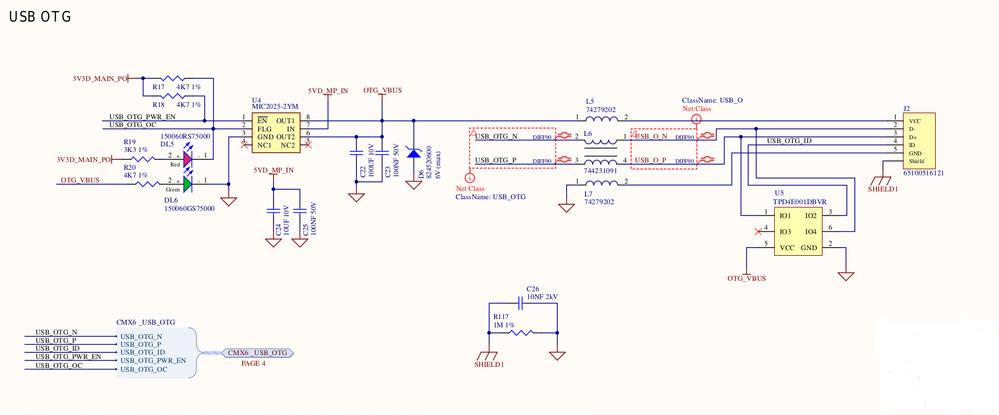

I am using an IMX6DL on a custom board and I am trying to use the USB OTG interface. I am currently facing some problems regarding the interface detection.
In particular, I have no information about the OTG interface on the dmesg kernel log and, even if I am sure the OTG Vbus power is on (thanks to led DL6), Linux is not able to detect any usb peripheral.
In the following you can find all the information about the schematic, the devicetree and kernel configuration.
- Schematic:
Signal connection to the processor:
Signal Name                  Processor pin            Pin Muxing
USB_OTG_N                  B6                               (this pin has no alternate functions)
USB_OTG_P                  A6                               (this pin has no alternate functions)
USB_OTG_ID                 W23                            GPIO1_24
USB_OTG_H1_OC         J20                             GPIO3_30
USB_OTG_PWR_EN      V5                              GPIO4_15
USB_OTG_OC                T6                              GPIO4_14

enricorossi
Hi igorpadykov‌,
Thank you for your answer. I checked the documents you sent me and I found a hardware problem on the board.
Kernel configuration and device tree were good.
Enrico

igorpadykov
Hi Enrico
one can check VDD_VBUS_CAP described in Figure 51-1. Power system overview
i.MX6SDL Reference Manual
http://cache.freescale.com/files/32bit/doc/ref_manual/IMX6SDLRM.pdf
check 24MHz crystal, probably replacing from working board. Use Chapter 6
Avoiding Board Bring-up Problems i.MX6 System DevelopmentUser’s Guide
https://www.nxp.com/docs/en/user-guide/IMX6DQ6SDLHDG.pdf
May be recommended to test usb in uboot or with bare metal SDK:
