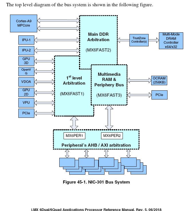

igorpadykov
suggestion was to use mass storage test with "dd", not g_ether.
NOC/NIC settings defines how data from usb module passes through processor buses.
For example below i.MX6Q NIC-301 Bus System, i.MX8M has much complex diagram
~igor

igorpadykov
>phrase “bus arbiter” is that arbitration has to occur between peripherals for access to send data to/from the ARM
not sorry. Not only to/from the ARM.
Between any peripherals.
igor
6,492 Views
igorpadykov
> arbitration has to occur between peripherals for access to send data to/from the ARM core.
not sorry. Data from/to usb module passes to memory also through bus arbiters
>Where is the competition for bus access happening?
arbiters can be configured for different policies, so that one bus master does not hold
whole bus, leaving some predefined bandwidth for other masters (even they are not working at all).
Just for reference one can look at arm NIC301 documentation
https://static.docs.arm.com/ddi0397/g/DDI0397G_amba_network_interconnect_nic301_r2p1_trm.pdf
Most full description how bus arbiters work is provided in Chapter 45 Network Interconnect Bus System (NIC-301)
i.MX6DQ Reference Manual
http://www.nxp.com/docs/en/reference-manual/IMX6DQRM.pdf
i.MX8M has similar bus arbitration scheme, but more complicated.
igor
