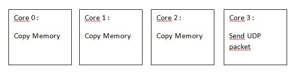

With the 3 first cores, I do a video process which uses memory and neon instructions.
With the last core, I send data through the UDP Ethernet.

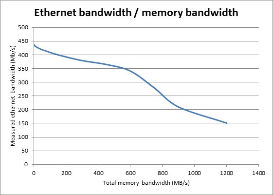

More the video process uses the global memory (200 to 600 MB/s), more the Ethernet bandwidth decreases (430 to 150 Mb/s).
Note: the same video process with small part of memory (in this case, data should be in cache), doesn't decrease the Ethernet bandwidth (always 416 Mb/s) (the same cpu usage, but low global memory usage).

I have written a simple test (code attached):
-    3 cores copy memory: 10 MB of data, by block of 64 kB. The memory bandwidth is measured and limited to a desired value for the test.
-    1 core sends udp packets (1472 bytes) : after 10s, the Ethernet bandwidth is calculated
1 thread memory bandwidth (MB/s)
Threads count
Total memory bandwidth (MB/s)
Measured Ethernet bandwidth (Mb/s)
Cpu usage (%)
0
3
0
438
5
1
3
3
434
7
5
3
15
429
10
10
3
30
424
11
20
3
60
417
12
50
3
150
400
20
100
3
300
379
35
150
3
450
365
46
200
3
600
341
62
250
3
750
279
73
300
3
900
210
84
400
3
1200
151
94
max
3
max
149
98
Result:
The bandwidth of the Ethernet depends of the global memory bandwidth usage.
- No memory usage: Ethernet bandwidth 438 Mb/s
- Max memory usage: Ethernet bandwidth 149 Mb/s
For my project, I really need the max of Ethernet bandwidth. I have spent many to time to adjust socket options, threads priority, the BSP versions,…, without improvement.
Is there any idea to help me go on?
Thank you very much.

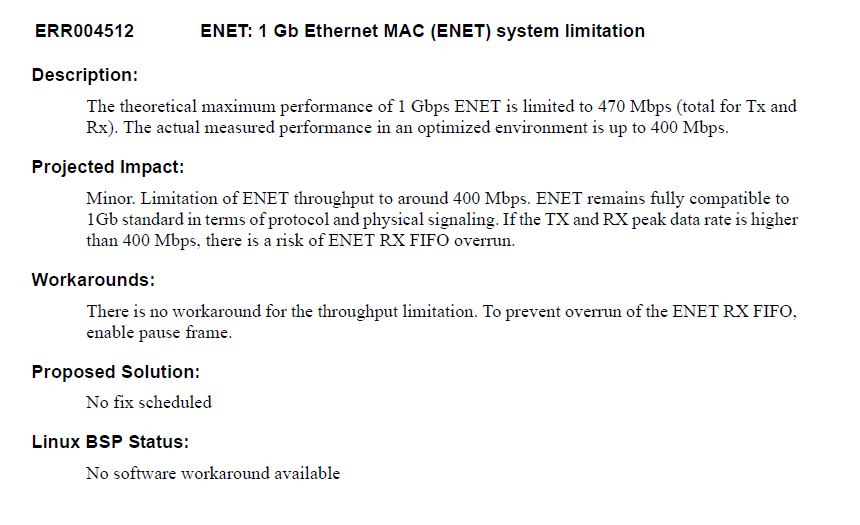

BiyongSUN
Please check the Chip Errata. It is long time ago, file the errata in document.
ERR004512 ENET: 1 Gb Ethernet MAC (ENET) system limitation
